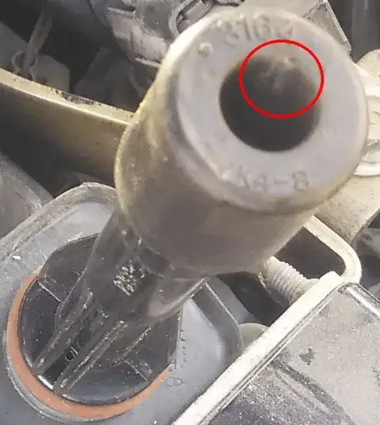

Thanks to a comment by @FredWilson on a different question about recurring arcing it became clear that when there is arcing on a plug, there is usually also a carbon trail on the inside of the plug boot:
This will contaminate the new plug fairly quickly and cause the misfire to return:
EDIT Nov. 28th 2016
So I pulled out all the plugs, and cleaned the porcelain sections and the plug boots with IPA and 320 grit sand paper to remove the carbon trails, then I slathered some 3M Silicone Paste ( dielectric grease ) on the porcelain part of the plugs and dabbed a little into the boots.
