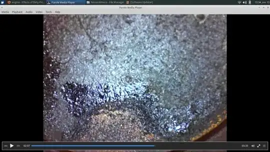

I just used an endoscope to take a look at my piston heads while changing my spark plugs and the heads had quite significant carbon build up.
So I'm curious, in general, what the common effects of this carbon build up can be.
EDIT
Here's a screen capture of one of my piston crowns, it's the only one which had a bit of a clear patch:
