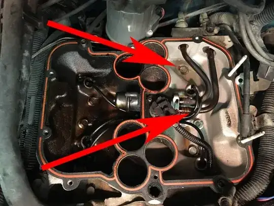

I ordered a new "Spider" (CMFI Fuel Injector Assembly) and "Nut Assembly" (Fuel Hose Kit), and here's what I found on first inspection:
intake plenum
Notice all the liquid fuel accumulation on the driver's side in the rear. Also notice the wetness near where the pressure side of the Nut connects to the Spider.

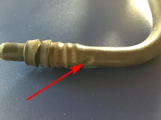

There was a pinhole where one of the fuel injector hoses wore a notch:
Nut- pressure side
I ended up not installing the rebuilt Spider because it was defective (Rock Auto, rebuilt by Auto-Line). I reinstalled my old Spider, which was functional and holding fuel pressure.

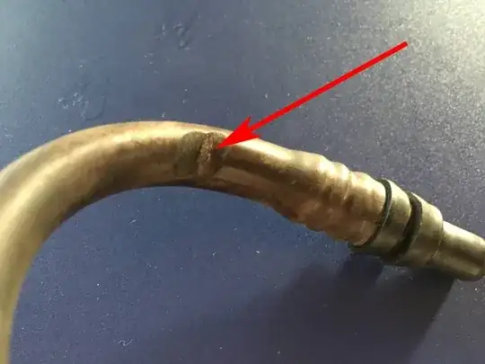

Now to explain the last piece of the puzzle... why during all these many months of rough idle, dieseling, and backfiring, did it always "pass" any/all leak-down tests? As you can see in the next photo, there was also a pinhole worn into the return line. The return line is never part of a leak-down test because it's only used when the engine is running.
Nut - return side
It was only after a second pinhole wore into the pressure line that the leak-down test revealed a problem.
Referring to my GMC manual, I see no "official" procedure for testing fuel pressure while the engine is running. I can look at pressure while the engine is running, but I could find no published specifications or tests. FWIW, according to tech support at Auto-Line, pressure while running should maintain itself between 55-60 psi. Since the return side simply dumps back to the tank, I'm not certain that testing pressure even while the engine is running would have revealed any information about leaks on this side.
Anyway, despite the other real issues I found and fixed, the vast majority of my dieseling, rough idle, and back-firing was caused by internal fuel leaks all along... first on the return side and then later also on the pressure side. Too bad the initial leaking started on the return line, where a standard leak-down test would never reveal this.
IMPORTANT: The fuel "leak-down" test will NEVER be able to reveal a leak on the gasoline return line. With everything else functioning properly, the return line can only exhibit its leak(s) while the engine is running. AFAIK, there is no test that can detect a leak on the return line, leaving only a visual inspection based on symptoms.
