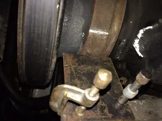

EDIT: Following the procedure posted on this website from this answer:
As you can see in the photo below, using the timing tab built into the timing cover would not yield an accurate measurement. So I clamped a steel plate to the power steering mount, which gave me a straight edge for making very accurate reference marks. (In this photo you can see that I've marked the timing groove and timing tab with white chalk)
http://s18.postimg.org/bzauk6aqh/IMG_5957.jpg

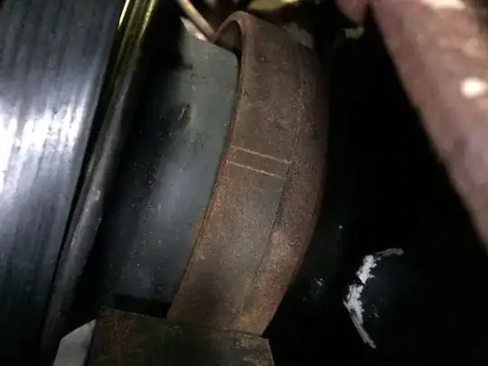

Then following the procedure as posted in the answer, I rotated the crankshaft clockwise while observing the rotor moving. I stopped and scratched a starting reference mark. Then while my helper observed the rotor, I slowly turned the crankshaft counter-clockwise, stopping exactly when my helper observed movement, and I scratched another mark. You can see these two scratch marks in the photo below.
  • Diameter of the balancer as measured by caliper: 6.125"
  • Calculated circumference of the balancer: 19.2422" (6.125 x π)
  • 19.2422" divided by 360 degrees => 0.05345" per degree
The measured distance between the two marks is 3/16" (0.1875).
(0.1875") divided by (0.05345"/degree) => 3.508 degrees
I repeated the procedure several times in different places on the balancer and always came up with 3/16".
