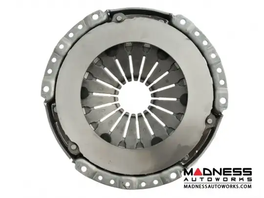

A basic clutch is made up of three major parts:

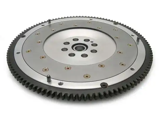

  • Flywheel
  • Friction disk
  • Pressure plate
(NOTE: These three pieces do not actually go together. I'm using the pictures for illustrative purposes.)
The flywheel is attached to the back of the engine. The pressure plate is attached to the flywheel. Sandwiched in between the two is the friction disk. The friction works a lot like brake pads, in that it grips the flywheel/pressure plate on either side through, what else, friction.
The splined input shaft of the transmission is placed through the friction disk and rides on a pilot bearing at the center of the flywheel. When you press the clutch pedal, the the throwout bearing is pushed against the clutch fingers, which pulls the plate away from the flywheel. When the pressure plate is pulled away, it allows for enough space between the to for a decoupling and the friction disk is allowed to spin freely. This disconnects the power output of the engine from going to the transmission. When you release the clutch pedal, the plate moves back towards the flywheel, recapturing the friction disk and power is restored to the transmission.

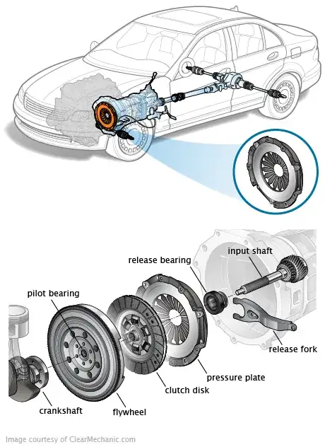

What are the parts?
The above diagram shows the basic form of most clutches.
The clutch has these three parts sandwiched together creating friction and syncing the engine and the wheels(through gearbox).

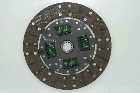

  • The clutch disc
Between the flywheel and the pressure plate is the clutch disc. The clutch disc has friction surfaces similar to a brake pad on both sides that make or break contact with the metal flywheel and pressure plate surfaces, allowing for smooth engagement and disengagement.

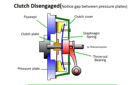

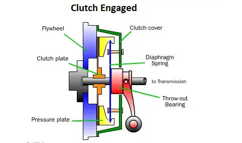

The below two images will show how clutch works when engaged and disengaged.
  • Disengaged
  • Engaged
