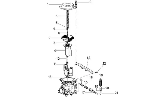

  • Number 7 in Image 2 - You will want to inspect your diaphragm for the CV carb for any tears or punctures. You can roll the rubber across your finger to inspect for a split. You can also use a liquid to see if you have a hole and allow the slide to sit with the diaphragm upright. A tear in the CV diaphragm will cause the engine to run very poorly and act as if it is air starved.
  • Number 11 in Image 2 - This is the slide block where your CV slide fits into. Check the inner portion of this for rough edges and any gummy buildup. Clean this surface well as well as the slide to ensure smooth operation.

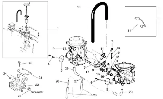

Here are two images of your carbs
Image 1
Image 2
