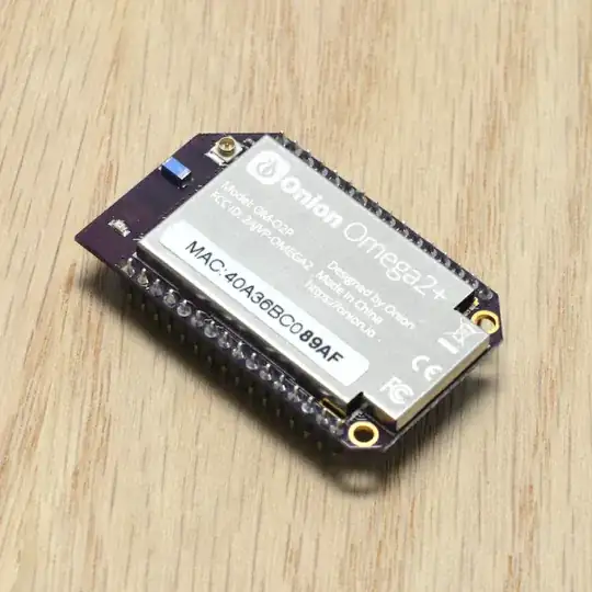

Well, I am a big fan of the Omega 2, which is not much bigger than a full size SIM card or SD card. It runs Linux, so there is your TCP/IP stack.
It has a good spec and will set you back a whopping $13.
580MHz MIPS CPU
128MB Memory
32MB Storage
USB2.0 support
2.4GHz b/g/n WiFi
3.3V Operating Voltage
18 GPIOs
Support for UART, I2C, SPI
MicroSD slot
Just by coincidence, I received their newsletter about 20 minutes ago and it describes a PoE project.
That will set you back another few bucks, so I will leave it to you to decide if it is "cheap". Hope this helps.
