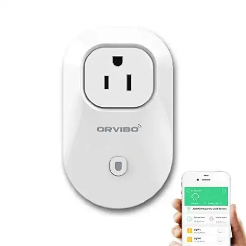

Another alternative that fulfill somehow my requirements, although it is not what I was thinking of, it is to install a commercial Wi-Fi power outlet. I find it bit expensive for the amount of units I need.
Here is one example from Amazon.
  • This solves my power requirements by taking the power directly from the power net.
  • Provides communication over Wi-Fi.
  • I can connect any microcontroller with a power adapter to it.
  • Since it is commercial Hardware I believe that it will provide some safety level of operation, in comparison to a testing board I could do on my own, I won't like to set the kitchen on file because a silly short cut.
Of course, the fun will be to develop the application by myself
Orvibo Socket
