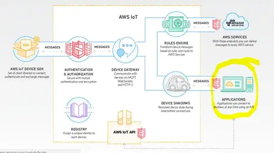

However, when it comes to visualization, I was hoping it wouldn't be necessary to reinvent the wheel.
AWS IoT
As you can see in the above picture, the IoT framework connects to an application server. My previous application experience was in a proprietary system based on PHP/MySQL & MongoDB.

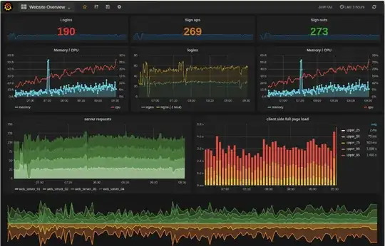

  • User ability to view live trending data on visualization tools, (something like Grafana would be appropriate. Grafana

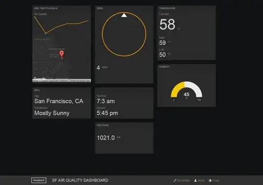

You can consider using freeboard.io that offers dashboards like this for example:
You can create unlimited public dashboards for free and limited private if you willing to pay monthly fees.
The project itself is open source and hosted on GitHub.
