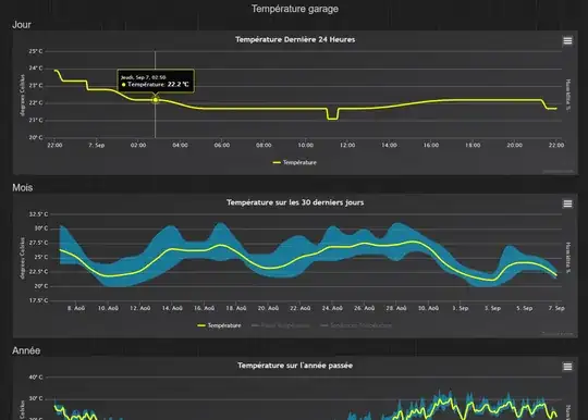

InfluxDB in Domoticz
This is a database provided with the Domoticz installation on Raspberry Pi. It allows to use data with time series.
Domoticz uses this to modelize sensors' data
