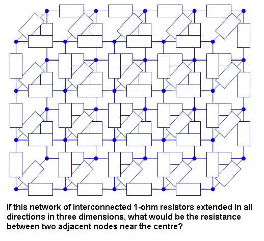

  • @PhilFrost I did think about this and concluded (rightly or wrongly) that the dominant conductance offered by air is the air most local to the surface of the insulator. I guess it could be modelled like an infinitely large cube of X ohm resistors forming square shapes - what's the resistance if you probe two nodes near the centre - it won't be zero and it won't be X but my math aint as good as it used to be. – Andy aka Feb 06 '14 at 21:34

  • @PhilFrost Hee hee - I'm adding this but in 3-D LOL – Andy aka Feb 06 '14 at 22:02

  • So this is an interesting thought, but why would infinitely small points result in an unlimited resistance? If you look at the grid of resistors in Andy's answer, I can pick two points there and there is some finite resistance. Does this not hold if we make the grid infinite, and 3-dimentional? – Phil Frost Feb 07 '14 at 18:36
  • Never mind, because this is already answered on physics.SE and you would seem to be correct. The explanation that made sense to me is actually in the comments: "You can't inject a current in a point without creating a divergent potential." – Phil Frost Feb 07 '14 at 18:47
