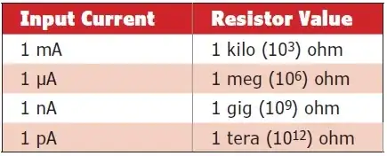

Now that is still very small so, if you have a specialist transimpedance amplifier with a feed back resistor of 10\$^{12}\$ ohms, you would generate a voltage signal level of 1.60217662 × 10-4 volts or about 0.16 mV. That is detectable as a signal.
The table below gives an idea about the resistor value needed to be to produce 1 volt for the given current: -
Note, 1 pA is approximately 62 million electrons per second.

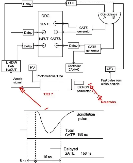

We know that voltage coupling of E fields from series to sensor shunt capacitance is transformed just like an resistive voltage divider except as a capacitive voltage divider. so the smaller the detector capacitance, the better for low attenuation.
schematic
'SCUSE ME, WHILE I SENSE THE SKY

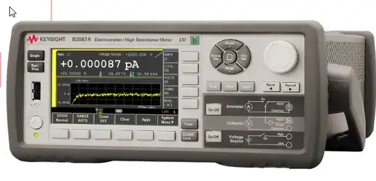

The Keithley B2987A is remarkable that it can measure resistances up to 10 PΩ \$(10^{16} \ Ω)\$
Here is the likely TIA circuit but the amp would be not a conventional internal compensated OpAmp with only 1~10MHz GBW product. To have high gain for a <~50MHz pulse
Tony Stewart EE75

  • This is an interesting application for very high resistance. None of this sounds familiar to me, but I have not worked on the equipment mentioned in the OP since mid- to late-80s. (The equipment was probably designed in the late 50s or early 60s.) Since it was sensing low power levels, a long time constant may have been necessary. Do you reject the idea of the 1 TΩ being a feedback resistor of a transimpedance amplifier? I sense you are more likely answering generally -- what can such high value resistors be used for? – RichF Dec 13 '16 at 20:22
  • Tony, I just visited your profile page. Its compact unicode chart of copyable EE characters is great! What was funny was that for my comment I had done a Google search to find the Ω character. Yours would have been much easier to find. – RichF Dec 13 '16 at 20:29
  • Yes it can be used for gain, but the interesting part is the large R feedback implies very low bandwidth TIA. Whereas for E-Field sensing or pC charge sensing it implies a very low cutoff for wideband HPF which is more useful. it would have to be free of creepage contamination on all conductive surfaces to achieve this and could potentially have very high voltages across it in kV or MV imposing a large size and could also be used for HiV step down voltage scaling, but usually Cap dividers are used for AC and R dividers for DC. So it could be used for HVDC which was popular in the late 60's.©® – Tony Stewart EE75 Dec 13 '16 at 20:36
  • This sensing equipment would fit the bill for "very low bandwidth". While the overall system was powered up, this particular sensing eqpt was kept off. Only when the system went down was it turned on. Let's call it an "off meter". High voltage was not an issue. ⚡️ – RichF Dec 13 '16 at 20:56
  • Was it used with a Tempest RF E-Field detector? to pickup CRT pixels across the street. – Tony Stewart EE75 Dec 13 '16 at 21:07
  • No. It was a low power neutron detection system. See the "/edit add" to the original post. And I meant "off meter" as in how off is it? – RichF Dec 13 '16 at 21:44
  • Actually neutrons have no charge so detection occurs indirectly by a light flash or scintillation effect using materials with 1e14 higher resistance than bakelite. (Quartz & Perspex) then with high voltage hitting Helium or similar cause the electrons to be ejected and be counted. So it is a very fast pulse with a slow rep. rate as I surmised in the beginning. – Tony Stewart EE75 Dec 14 '16 at 00:24
  • I am aware of the indirect sensing, but I was talking about the circuit which the sensor fed, not the sensor itself. Does the slow rep rate help support the TIA theory, your theory, or both? – RichF Dec 14 '16 at 00:30
  • I think @Jonk may know better with his direct experience. I have measure similar pulses but used equipment not available back then from Lecroy scopes with >1Gbps sampling rates. So some Scintillation counters used a integration method and measured the pulse shape by gated integration times in microseconds. For me to guess where it was used would like matching the exact resistor part number in Digikey without enough info. My guess is it could used both ways. – Tony Stewart EE75 Dec 14 '16 at 00:48
  • For giggles You can try it out on a CMOS inverter and use it for feedback. then have the output drive an LED with the input going to a short insulated wire with 10k in series to ESD protection. Then use it to measure people walking by due to their static charges. – Tony Stewart EE75 Dec 14 '16 at 00:50
