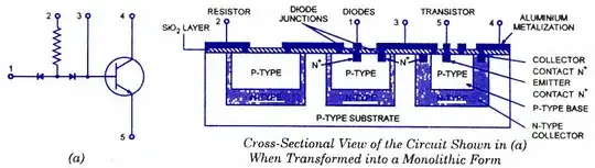

Most commercial IC circuits are isolated from the substrate material by a reverse-biased P-N junction (including CMOS parts). The substrate is usually tied to the voltage expected to be most negative.
If it isn't, then that junction becomes forward biased and can conduct a great deal of current, melting metal or heating the junction to the point where it no longer acts as a diode. That is typically at a voltage of about 0.6V, but the IC makers play it safe usually by telling you not to go lower than -0.3V.
(referring to the below diagram, but not shown, the substrate would be tied to pin 5)
Most CMOS parts have another twist that if part of the chip has a normal Vdd and another part sees a big negative current it will trigger a big parasitic SCR that is a side effect of the structure, then the device's power supply draws a large current which causes overheating, melting etc. if the current is not externally limited. That is called latch-up.

    Nice answer, lots of upvotes, unfortunately it is incorrect. Latchup is a different phenomenon. In IC design it can be avoided by having enough substrate contacts, this is also checked during design with automated tests. – Bimpelrekkie Jun 16 '15 at 15:40
    @Rimpelbekkie Nope. The trigger current can be increased, but the effect cannot be eliminated totally except by going to an insulating substrate such as sapphire because the four layers of a thyristor are still here. The current is not limited in the situation under discussion here. – Spehro Pefhany Jun 16 '15 at 15:51
    Nope what ? Latchup is a real phenomenon, no doubt there. Is it the reason that a lot of current flows when the supply is reversed ? NO ! If you disagree, explain to me how the thyristor equivalent circuit pictured above can conduct when VDD is negative with respect to ground. To trigger the thyristor, VDD must be positive and enough voltage must exist across Rwell and/or Rsub. This can only be caused by having too few and too distant substrate contacts. I have been designing ICs for 25 years, have yet to see one with a latchup issue. – Bimpelrekkie Jun 16 '15 at 17:26

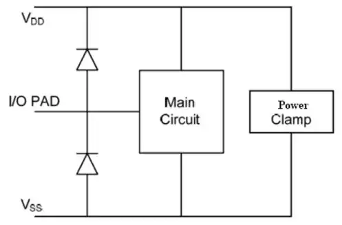

A late answer, I came here via another question but noticed that actually none of these answers address the real reason why almost any IC / Chip can be fried by applying a reversed supply voltage.
The real reason is that all chips need to have ESD protection on all pins that are not supply pins with a circuit like this:
on-chip ESD protection circuit
So almost every pin has this ! That is a lot of diodes in parallel. You can easily destroy all these diodes by reversing the supply. And that actually destroys your chip.
Latch-up as mentioned above is an effect that occurs when the supply has the correct polarity but a current is sinked or sourced on an input or output causing a malfunction as explained above. It has nothing to do with reversing the supply ! If you think I'm talking nonsense then please look up how a Latch-up test is performed. There is specialized measurement equipment to do such test.
Please read this excellent article explaining latchup and note that the supply is "normal" so not reversed ! When still in doubt read the EIA/JEDEC STANDARD IC Latch-Up Test EIA/JESD78.

  • Hi, sorry I am late to the party. If you apply reverse voltage and burn the ESD diodes, why would the chip be destroyed? It would still work, albeit have no more ESD protection, right? – tobalt Dec 17 '21 at 07:25
    @tobalt You're assuming that all the ESD diodes fail open, then you're right. But what if one or more fail short, which is often what happens. Also, even if the ESD diodes survive, there are still MANY PN-junctions (diodes) inside the circuit itself that you will destroy by applying a reversed supply, as then, these PN junctions go in forward mode. Note how reversing the supply violates the absolute maximum ratings of almost any IC, that means there are no guarantees that the IC will still work. It could but all bets are off. – Bimpelrekkie Dec 17 '21 at 09:06
  • Yes right, I was assuming the open-fault, which is quite a stretch. Thanks. – tobalt Dec 17 '21 at 09:10
