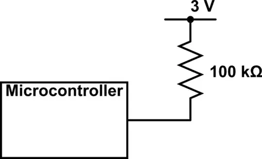

I'm trying to understand power budgets a bit better and I have a question regarding pullups. I have a input to a microcontroller that needs to be logic high at all times. The micro goes to sleep now and again, so the internal pullup isn't an option. Looks like so (wow that's big).
schematic
I'm dealing with a low power, battery-operated system here (2 AA batteries), so every bit of power savings counts. My question is how to figure out how much current this draws. If I just look at V = IR, we're talking 30μA, which is actually a lot for this application.
What I don't really understand is how to factor in the microcontroller. I'm assuming there's something I need to factor in from the datasheet, but I don't know which elements are relevant.
The 100k resistor is from a reference design, but is there anything stopping me from putting a much bigger resistor to cut down on current draw?

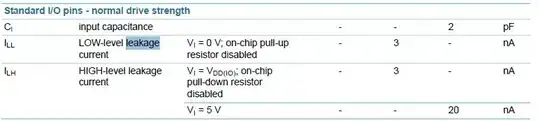

Leakage
Based on some comments, it looks like leakage current is the microcontroller spec I should be interested in. Below is what I found in the datasheet. Is 3 nA the magic number?

You need the input leakage current. This question has a good discussion of what's actually happening. Basically, the input transistors present an effective resistance of megaohms to gigaohms and the current flowing will be extremely small. That discussion also says you can usually increase it to 1Mohm.

    But as the external pullup must have a much lower resistance than the input resistance (presumably to ground), it makes little sense to increase the external pullup. It will only increase the sensitivity to disturbances (but maybe the input level is never read). – Wouter van Ooijen Jan 13 '14 at 21:49
    Agree with @WoutervanOoijen. In fact, assuming that the microcontroller pin in always an input, making the pull-up zero ohms to 3.3V would not significantly change power consumption. The 100K resistor protects you in case you accidentally drive the pin low. – DoxyLover Jan 13 '14 at 22:44

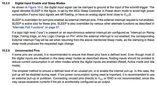

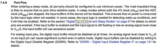

Internal Pullups are 20 to 50kΩ. Typical Characteristics are measured with pins as inputs and internal pullups enabled. Sleep modes affect input pin logic state, and current consumption. They can and are used in sleep modes. Only difference is the value. Your 100kΩ is larger and has a better fixed/known value.
Relevant sections. All these are pulled from the ATTinyx5 series MCU Datasheet, but are typical of most ATTiny and ATMegas
enter image description here enter image description here enter image description here

There is a trade-off on high resistors values. That turn inputs more susceptible by noise.
Your calculation of 10\$\mu\$A assumes that the microcontroller input is at ground and the full supply voltage is across the resistor. But the resistor will pull the input pin high and there will be virtually no voltage across the pullup resistor (most of the time). Therefore, the current through the resistor would be zero for an ideal CMOS input pin, after a few microseconds of charging time.
The key parameter is the input leakage current, as you have seen from the datasheet. If you are pulling the pin high then it is the high-level leakage current that is important, and the typical value of this parameter is 3nA. I wouldn't use that value if you really care about power consumption, I would try to find a worst-case value in the datasheet or use the 20nA figure (worst-case if the input is pulled up to 5V).
In fact, if the pullup resistor is on a pin that is always an input then the value of the pullup resistor is hardly important. You could use 10k\$\Omega\$ instead and feel better about noise immunity.
