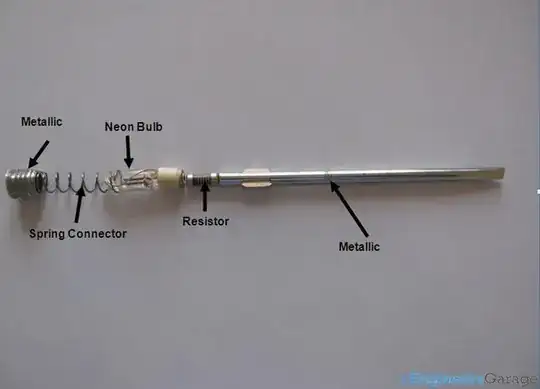

The resistor in series with the neon is usually the component that limits the current. It will vary between devices but, about 0.5mA appears to be the limiting current (for NE-2 bulbs) and, given that the neon itself will "strike" at about 150V (peak), the resistor will be limiting current to about 0.5mA with a voltage across it of about 150V - this is for a 220VAC circuit. This implies a resistance of about 300k ohms.
However, I suspect that neons used inside screwdrivers are going to work on 110VAC and they are possibly 60V types. This means that the volt drop in the resistor will be about 250V (peak) on a 220VAC supply, implying a resistance of about 500k ohms. But this does not take into account human body capacitance in series (see further below).

There are resistors in series with the neon inside the screwdriver body but the normal impedance is largely capacitive with the resistors present there as a safety device should the neon become directly connected between live and neutral/earth: -

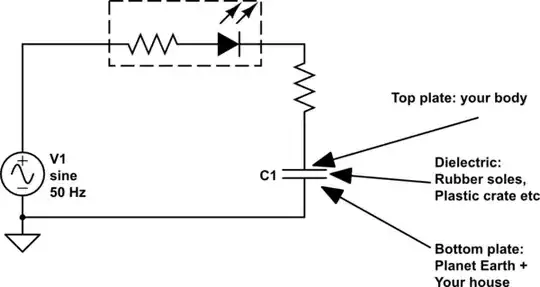

how one may represent the system hot wire - screwdriver - human body - wooden floor - building - ground as an electrical circuit,
I've long assumed it to be something like this:
schematic
