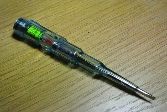

Many years ago I bought a multi-function testing screwdriver, the instruction sheet (which I have mislaid) claimed you could use it for a surprising number of tasks:
  • Continuity of fuses
  • Mains voltage present (barrel marked "70-240V" and, amusingly, "CE")
  • Locating a conductor break inside a mains-lead
  • Checking your microwave oven for microwave leakage
If you hold the blade and place the top near a wall it lights up near buried 230V wiring (e.g. for light switches) but isn't very reliable.
If you touch the blade to an earthed condcutor (e.g. radiator or water-pipes) and press your finger on the metal cap, it lights up.

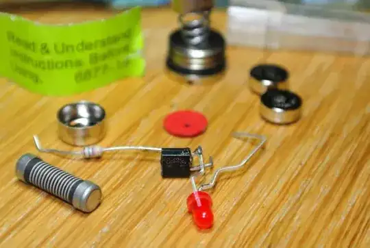

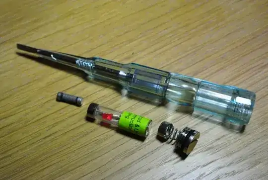

I took it apart, there is a 3-pin device in a TO-92 package labelled
   KSP
    13
  -135
I guess this is some sort of transistor.

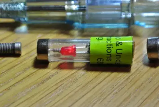

There is also what seems to be a very high value resistor (too high for my cheap multimeter to measure)
Inside the capsule are also a LED, a small resistor and two small button batteries.
Here are some photos
tester
dismantled
innards
electronics
Surprisingly, it still works after I reassembled it.

It's an LED turned on by a transistor! The base (gate?) lead connects to the screwdriver blade. Yes, all sorts of tricks and useful applications are possible with something this simple.
The resistor is a few-KVs high-volt type, probably chosen out of extreme safety paranoia (since customers might use it on a 440V breaker or worse. Can't have resistor arcing over internally!)
If the transistor is a JFET or an hfe~5000 Darlington, the ohms value can be extremely high: turn on 1mA LED using 50v signal input, Base resistor can be
50v/(1mA/5000) = 250meg
and 250v/250meg = 1uA, so it's pretty safe, electrocution-wise, plus offering lots of ESD protection to the transistor.
Try sweeping the driver blade across cloth or plastic sheet while touching the button. If the LED flickers, then the transistor is probably a JFET.

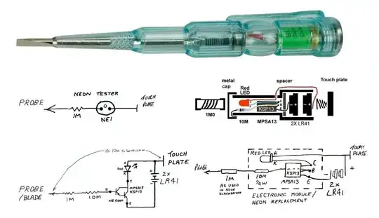

circuit diagram
This should give you all you need to understand this useful little tool!
user102552
  • 31
The transistor is a ksp13 Darlington. Your picture is unclear, but you can decode the resistor code here. Circuit diagram here. Hope this helps...
