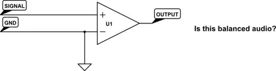

An ideal balanced audio receiver is a differential amplifier. It works by measuring the difference between its two inputs, and calling that difference the signal. "Ground" is totally irrelevant. One input need not be an inverted copy of the other input. How could it matter, if a differential amplifier is only looking at the difference between its two inputs? How could it know that one input is "the inverted signal"?
Why then, not simply connect one of the inputs to ground? Wouldn't this mean we can make any unbalanced audio into balanced audio just by using a differential amplifier on the receiving end?
schematic
As it happens, no, we can't do that, and to understand why is to understand what balanced audio really means. It's not about having two single-ended audio connections, but with one inverted. It's about having the signal be carried on two conductors with equal impedance.

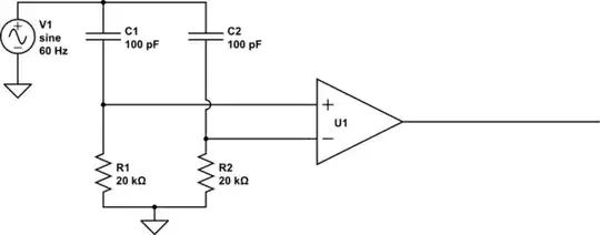

Here's why: the primary objective in using balanced audio is to reduce noise. This noise is picked up by mutual inductance and capacitance with other stuff (frequently: mains wiring) near the audio signal. If the mutual inductance or capacitance to this noise source is equal for our two conductors, then equal voltages and currents will be induced on each conductor. That is, their difference will not change. Thus the noise source, from the perspective of our differential amplifier which only looks at this difference, doesn't exist. Consider:
schematic
simulate this circuit
What's the output here? To the extent that U1 is an ideal differential amplifier, the output is exactly 0V DC. Some of the noise (from V1) couples into the inputs through C1 and C2, but because C1=C2, and R1=R2, it couples into each equally, and thus can't change the difference between the two, so can't affect the output of the differential amplifier.
But what happens if R1 is not equal to R2? R1 and C1 now form a different voltage divider than do R2 and C2, resulting in unequal voltages coupling into the amplifier's inputs. Now there is a difference, and V1, to some extent, is found in the output. The same problem exists if the resistors are equal but the capacitors are not.
Driving just one of the inputs doesn't change anything. Consider:
schematic
Hey that's not balanced! But it totally is balanced. The noise still sees equal impedances to each of the inputs. The noise still couples equally into each input, thus not changing the difference. Thus, it's still rejected.

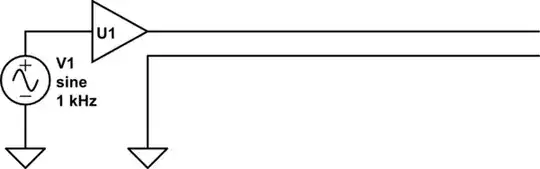

There are two reasons your typical audio connection such as found on an iPod or a VCR isn't balanced. The first is the cable geometry. Usually these use coaxial cables, with the ground as the shield, and a ground-referenced signal inside of it. Because the shape of the conductors isn't even remotely similar, they can't possibly have equal impedance to their surroundings. In terms of the prior examples, C1 and C2 are not equal.
The second is how these lines are typically driven. They usually look something like this:
schematic
If U1 were an ideal buffer, this would be balanced. But it's not: U1 is usually some sort of op-amp with a small output impedance. Though it is small, it's not nearly as small as the direct connection to ground seen by the other half of the cable. The op-amp's output impedance probably also varies significantly with frequency.

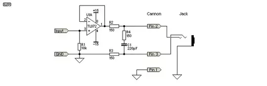

A very cheap, and very effective solution to this problem is to set the output impedance with something more controllable, like a resistor. We can put a resistor on the order of 100 ohms in series without significantly attenuating the signal. A practical implementation looks like this:
balanced audio line driver
This is from a great article by Rod Elliott (ESP) / Uwe Beis. R2 and R3 do most of the balancing: these resistors can be purchased or trimmed to have very equal resistances. Since they are significantly bigger than the output impedance of the op-amp, the op-amp's output impedance is relatively insignificant.
R4 and C1 serve to further render the op-amp insignificant at higher frequencies. Real op-amps have increasing output impedance with frequency, which would serve to unbalance the circuit at high frequency. However, the op-amp's output impedance becomes less significant at higher frequencies as R4 and C1 shunt the two halves together.
This topology is not without a few disadvantages. Firstly, since it can't drive both lines, it has half the dynamic range compared to a design that can drive both lines. Secondly, it drives the two signal lines with a common-mode voltage half that of the input signal. The driver must thus drive the capacitance of the two signal lines to their surroundings, like the shield in typical audio cables. However, for moderate cable lengths this is unlikely a problem.
The advantage is reduced parts count. Also, if this is on a TRS connector which gets shoved into an unbalanced input, nothing bad can happen, since the ring, which is normally "inverted signal", isn't connected to any active electronics.
More importantly, it dispels a common misunderstanding about how balanced audio works.

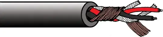

Balanced cable.
A balanced cable has two conductors ("legs") of equal impedance and with equal exposure to external fields, usually achieved by twisting the two conductors together. Occasionally each leg is itself a pair so there are 4 conductors interleaved and tightly twisted in star-quad configuration.
The equal exposure to external fields means that any electrostatic coupling from an interference source into the cable will generate the same voltage on each leg, and any magnetic coupling will inject the same current into each leg.
A ground connection is not necessary for a balanced signal though a screen can reduce interference from external signals as well as radiated interference to other signals. If a screen is present it is often connected at one end only to eliminate ground loops. At the system level there will generally be a ground connection to the equipment at each end of the signal, though it may be shared between 2, 50 or several hundred balanced signals.

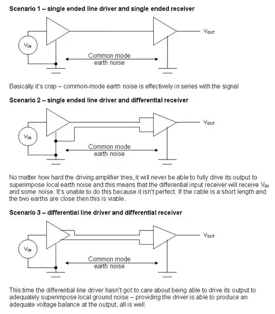

The issue is, as you say, that in a balanced signal the actual signal value is the difference between two signals driven oppositely. In a single-ended signal, there is still a difference, but the difference is with respect to ground, which is also the reference for all kinds of other signals.
If you had a completely floating device, like a speaker with a battery powered amplifier built into the box, then there is no difference between a balance and single ended signal. Both provide two wires, and the signal you want is the difference between them.
However, rarely do we have receiving devices that can truly float at arbitrary voltage. The issue is that with a ground referenced signal, it is pretty much impossible in a practical sense to treat both lines equally. External noise will not couple the same onto a signal line as it will a line used as ground by parts of the system. This is in part because ground is used as the reference for most signals, so by definition doesn't change.
Even in the example of the floating battery operated speaker amp, care would have to be taken to not treat the two input lines differently. This is harder than it may appear. For example, if you tie one of the lines to your local ground, and that is connected to the chassis or ground plane of your circuit, then external noise will couple into that signal more easily since it presents a higher capacitance to the outside. Since the amp uses that as a reference, it can't see the noise on the ground line, but the unequal pickup of the noise by the two lines will show up as a differential signal, which will be detected and amplified.
So overall it's not just about encoding the signal as a difference between two lines. As you say, that is always the case anyway. It's about setting up the system so that those two lines can be treated equally, and thereby pickup equal noise from the outside world. By then encoding the signal equally but with opposite polarity on both lines, the receiver can take the difference, which in theory cancels out any noise picked up equally by the two lines.
A "balanced" audio signal is therefore three lines. The two signal lines with equal impedance, equal treament in the cable, and driven oppositely with the signal, and a separate ground line that is the 0 reference for everything. In a high quality balanced audio cable, the two signal lines are a twisted pair surrounded by a shield connected to ground. The shield blocks capacitive pickup from outside, and by twisting the two signal lines around each other they will have coupling to the outside that averages out to be equal over relatively short distances.

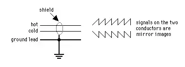

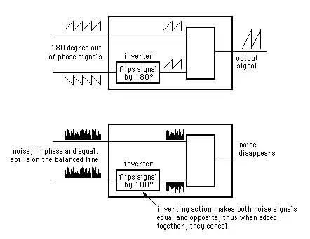

I'll used images from this tutorial
The balanced audio wires transfer the same signal but with 180 degree difference between them.
When noise is introduced into the cable, it is introduced equally to both the original and the inverted signal because they have both the same impedance. The receiver then inverts one of the signals and the result is two in phase signals that contain the original audio and two noise signals with 180 degree difference between them. When these signals are summed the result is the pure audio signal with the noise removed (canceled).
When using a single ended wire to transfer the signal then one wire transfers the signal and the other one the ground itself so you can't follow the same process as with the balanced signals to remove the noise.

  • "so you can't follow the same process as with the balanced signals to remove the noise." Why not? Does noise see the cable and realize, "oh wait, this one is labeled GND, so I'm not going to affect this one equally?" Does the noise see that you've inverted the cold line? Somehow I don't think noise is that smart. – Phil Frost Jan 08 '14 at 15:13
  • @PhilFrost A signal by itself has no meaning, it needs a reference point (which is the ground in this case) so how exactly can you invert the reference point? In relational to what? – alexan_e Jan 08 '14 at 15:23
  • Measuring the difference between two things is equivalent to inverting one thing and adding it to another. Why not measure the difference between ground and a single-ended audio signal? How does making a cold signal that's the inverted signal change anything? – Phil Frost Jan 08 '14 at 15:29
  • @Phil I may be wrong, but I think from these comments that the idea you're missing is that noise affects all of the conductors (with a given impedance) equally, adding a net gain (or loss) to each equally. When one of the signals is inverted it cancels out the nearly identical noise on the other side. So imagine a +1V on "hot" and a -1V on "cold" representing the desired signal. When "cold" is inverted, the result is a +2V value. If a noise spike adds +0.05V to both signals, you then have +1.05 on "hot" and -0.95 on "cold". 1.05 plus the inverted -0.95 is 2V again, and the noise is removed. – JYelton Jan 09 '14 at 19:47
  • @JYelton the problem is that it's not the "inverting" that removes the noise: it's looking at the difference between two equal impedance connections. Analog telephone networks have only two wires, and there is no ground, so you can't "invert" one of them. You can only look at the difference. – Phil Frost Jan 10 '14 at 01:51

Your balanced audio transmitter and receiver, by contrast, each have three conductors:
  • Hot: i.e. the signal (plus any noise). Typically connected by one core of a shielded twin-core cable.
  • Cold: i.e. the inverted signal (plus any noise). Typically connected by the other core of a shielded twin-core cable.
  • Shield: usually grounded at some point in the system as a whole. Typically connected by the shield of a shielded twin-core cable.
If you connect the signal of your "unbalanced" line to the hot pin of your receiver, then the effect will be just as for case 1. or 2. above, plus your signal's amplitude may be affected depending upon the receiver's circuitry. If you connect it instead to the cold pin, then the effect will be just as for case 1. or 2. above, plus your signal's amplitude may be affected depending upon the receiver's circuitry and you will invert the phase of your signal.

It's fairly crucial that this second voltage is conducted by one or more conductors of as close in dimensions and impedance and location to the one or more conductors carrying the uninverted voltage. That's why most balanced audio cables use a twisted pair of conductors, often with some packing material (cotton thread; fine plastic tubing; etc) to prevent the pair from separating. Here's an illustration from Canford:
Exploded drawing of Canford Helical Screened Twin audio cable
Some balanced audio cables, like StarQuad, use a pair of twisted pairs: two cores for hot, two for cold.
By creating a path for the cold signal that has very very nearly equal impedance and dimensions and location as the path for the hot signal, it minimises the difference between noise induced in the hot signal and noise induced in the cold signal, yielding a very high rejection of that noise.
If we didn't do this, wouldn't noise still affect both halves equally, and still be rejected by the receiver?
No; or at least, not to anything like the same extent.
  • Creating a return path with equal impedance is one thing. Requiring "cold" to have the opposite voltage with respect to ground as "hot" is another. Which is it? – Phil Frost Jan 08 '14 at 20:36
  • IIUC, both! The former strictly speaking, and the latter by convention. Ask an audio engineer at a recording studio or live sound venue to give you a line-level balanced out, and (s)he'll typically proffer a male XLR (or stereo pair of them, etc) with cold being out of phase to hot and both of very close impedance. However, since your comment suggests you may not be so interested in the conventions, possibly of interest to you is this SuperUser answer about using Cat5 (i.e. unshielded) twisted pair for audio. –  Jan 08 '14 at 23:16
The "equal and opposite" explanation has been around for decades. It is grossly oversimplified and provably wrong. We use balanced interfaces because they reject noise, NOT because they can add 6 dB of gain. A look at a complete interface (driver, line, and receiver) will reveal nothing more complicated than a Wheatstone bridge. When this bridge is balanced or "nulled", common-mode is rejected. If you do the math to calculate noise rejection or CMRR (common-mode rejection ratio), you'll notice that there's not even a place for signal voltage in the equations. Noise is rejected with or without signal! But this idea confuses many, so much so that when I volunteered in 1999 to fix the CMRR test in IEC standard 60268-3, we added an informative annex which follows here: "60268.3 OD IEC:2001 - 111 - Annex A (informative) Balanced interfaces

You don't need a screen or third wire to have audio balance - I thought I'd just throw my opinion in and agree with what I think Phil is objecting to. What I've drawn below is how I perceive a balanced situation (scenario 3): -
Another advantage of scenario 3 is that external interfering noise sources become "balanced" on the line because the differential driver "projects" an impedance that is largely identical on both lines i.e. at any point on the cable both wires project the same impedance to ground local or otherwise.
Twisting and screening is superfluous to the question I believe but, helps a lot as we know!!
I'm not saying scenario 3 has output lines driven in antiphase but, given that the driver has all the circuitry to create a balanced "neutral" output then, it makes sense, from a signal/noise point of view, to drive both lines antiphase.
Andy aka
