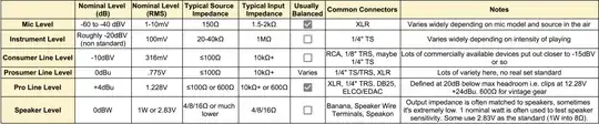

Just wanted to add a little more about typical values for signal level and impedance. Take all of this with a grain of salt because these things vary widely between different pieces of equipment. These are all just ballpark ranges.
Nominal level chart
These standards have changed over time too. For example, it used to be that most professional line level gear had an input and output impedance of 600Ω. Modern line level gear usually has a very low output impedance and a high input impedance for bridging instead of impedance matching. This makes it easier to drive line level inputs since you don't need as much current.

You have to be careful about mixing consumer and pro line level since they are not directly compatible. You might end up clipping a consumer device's input if you give it pro line level, or you'll have a weak signal if you do the reverse. That's why people buy things like this. It's also not difficult to build an interface like that. To go from consumer to pro line level, all you need is an amp with about 12dB of gain (high input impedance and low output impedance of course). To go from pro to consumer, you need about -12dB of gain which you can easily get from a 10k:600Ω transformer (4.1:1 turns ratio). [Don't try this backwards to go from consumer to pro, you will get tons of noise and loss due to the step up in impedance]. Impedance isn't usually a huge concern here since most line level gear has very low output impedance and high input impedance.
A lot of companies make stuff that's considered "prosumer" now which has a nominal level of roughly 0dBu (.775V RMS) or so, in between pro and consumer line level. That stuff varies a lot as well and it's designed for people who want to make decent recordings at home or on the go. Those people might have a mix of pro and consumer line level devices which is why prosumer offers them some flexibility.

    I should also point out the difference between dBu and dBV. 0dBu=.775V while 0dBV= 1V. All of these voltages are RMS. You can read more about that here – Avid Pro Tool Feb 14 '19 at 19:54
