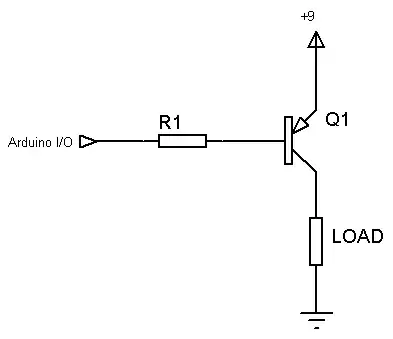

Things regarding a high side switching of a voltage higher than the control voltage are not as simple as they seem.
Take for example the following circuit controlled with an Arduino I/O pin enter image description here
When the I/O pin is LOW the voltage to the base will be 0, that means that the Vbe will be 9v and since it is >0.7v the transistor will be on.
When the I/O pin is HIGH the voltage to the base will be 5v, that means that the Vbe will be 4v and since it is >0.7v the transistor will also be on.
So basically that configuration can't work as a switch because the transistor will always be on.

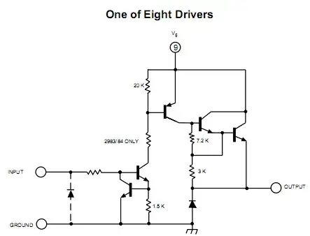

Another alternative is to use a device like ULN2003/2803 but intended for high side switching. Such a device is UDN2981 which has 8 source drivers like the following and can be used as a high side switch controlled by TTL level logic. enter image description here
