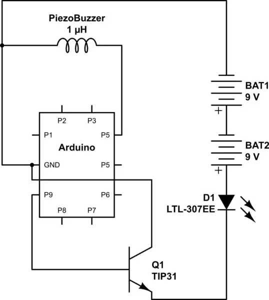

I was having an issue getting this setup to use a separate power supply and still operate properly with the buzzer. I'm using NPNs (TIP31) that are setup the following way (from memory, so hopefully I recounted it right, but the setup is functional):
  • Base -> Arduino output pin
  • Collector -> GND on the Arduino board
  • Emitter -> LED (-)
  • V+ -> LED (+)
  • V- -> GND on the Arduino board
V+ = 18V via 2x9V batteries
Arduino powered by a separate onboard battery.
Simplified schematic attempt below (doesn't show 2nd set of LEDs and 2nd transistor)
schematic
My issue was that, when the buzzer is connected (even if its not being operated) the LEDs were staying lit. I'm pretty sure it has to do with the Arduino board and the separate power supply for the LEDs sharing a common ground. Disconnecting the ground from the (-) terminal of the buzzer confirms this.
Is there some way I can set this circuit up to have separate grounds, and would that even help? I figured I could use optoisolators to fully isolate the circuits, but I don't have time to order any in. Is there a solution simply using the NPN transistors I have available? Total novice here, so please bear with me!

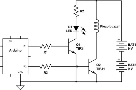

Your NPN power transistor seems to be connected up wrongly.
I'd expect something like this ...
schematic
where
  • R1 limits base current and protects P1. \$R_1 = 5V - V_{BE(sat)} / I_B(20mA?)\$
  • R2 limits LED current. \$R_2 = (18V - V_{LED} )/ I_{LED}\$
  • Q1's collector is connected to the LED's cathode.
Perhaps your LED is actually an 18V LED module that has current-limiting built in?
Note: I believe piezo buzzers don't draw much current, you probably don't need a TIP31 to drive it. Check the specs and choose a more suitable transistor. To be connected as shown, the piezo buzzer should be rated for more than 18V.

  • OP indicates a desire to deafen as well as blind his/her Xmas sweater victims. If one presumed the piezo would be louder running directly off 18v than it would be if powered from the microcontroller pin, would you just essentially duplicate the Q1 setup with another TIP31 functioning as a low side switch for the piezo? I would guess R1 stays in place but depending on the buzzer maybe R2 goes? – mikeY Dec 04 '13 at 15:55
  • @mikeY: Those are good points. – RedGrittyBrick Dec 04 '13 at 15:59
  • Good question mikeY - I have a new piezo spec'd for 3-12VDC so diverting more voltage to it may be necessary. Going to see how it sounds relative to the smaller one I had going previous when running straight off the board first. I'll give this a shot when I get home. Appreciate the quick response! – ccrook Dec 04 '13 at 16:09
  • Just to make sure, because the page here for the old piezo mentions using 2 I/O pins for it: If I did use a second IO pin instead of ground, it is still effectively the same circuit if that second IO pin is set LOW? – ccrook Dec 04 '13 at 16:20
  • This is RedGrittyBrick's answer so I don't want to steal his thunder, but I would be inclined follow this set up: http://lilypadarduino.org/?p=436 at least initially. I was asking questions above because I didn't know and we didn't have the specs on the piezo; with the additonal information a little Google suggests the above link is the way to go. – mikeY Dec 04 '13 at 16:39
  • Wanted to say thanks -- I tried this out last night and it works like a charm! I removed one of the 9V batteries as I'm not powering enough LEDs at a single time to warrant requiring both, and it keeps voltage in the operating range of the piezo, which is still sufficiently loud.
