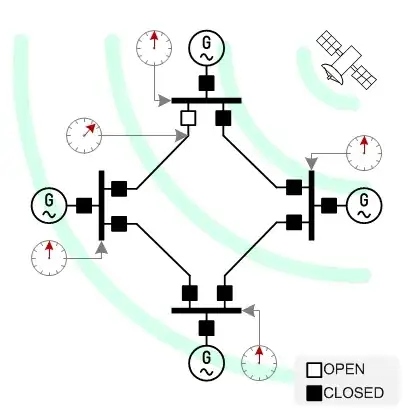

Let's say that your hypothetical ring system is exactly 1/2 wavelength in circumference.
Now, let's suppose that you start each generator by synchronising it to the local frequency, which is how it's done in real life. (In really olden days, using three lightbulbs, in olden days, using a synchroscope; these days using a auto-synchroniser.)
The clock faces represent phase, as measured against a global reference (say GPS time.) We do, indeed, have a problem. At the open breaker there is a 180 degree phase difference, and closing the last breaker is likely to make something explode.
The trick is that generators are started in synchronisation with whatever the local frequency is, but once they are running, they are slowly adjusted to be in synchronism with a common phase reference - say GPS time.

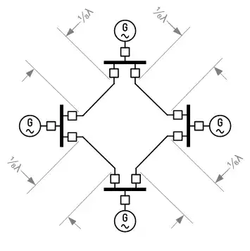

Now you only have a 45 degree phase difference across the open breaker, which is more manageable.
In practice, no part of a ring system like this would be a eighth-wavelength long (1000km?) so the phase difference would be less than 45 degrees.
In practice, I have never heard of this being an issue. Possibly because real world networks aren't long enough; or GPS phase synchronisation is implemented as above; or possibly because transmission networks are not built as rings, but as rather more densely connected meshes where there are many short interlinks between nodes, which act to equalise frequency within the local "neighbourhood" of substations.
