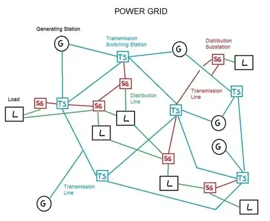

What equipment would be involved in "rerouting" power to minimize the possibility of blackouts?
Transmission switching stations re-organize things when there are problems with generators or section of grid: -
As you can see, every generator connects to the (national) grid via a TS. This wiki page should help. Pictures taken from here or here if not a Quora member

    I think you may have dropped below acceptably minimalist level there :-). "Pages from here" does not work for non-[highly invasive permissions requests so not accepted]-Quora members. And the Wiki is a bit of a wade and neither specific nor general enough (IMHO). I've added a link to the Quora source of that image (found with Garglabet image search). – Russell McMahon Jul 12 '16 at 11:46
    @RussellMcMahon The picture reference was just to give credit and I'm not a quora member yet I can see it. The wiki page has a section for transmission stations and that was the point!! – Andy aka Jul 12 '16 at 11:54
