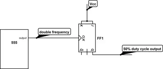

If you need an accurate 50% duty cycle, a simple 555 circuit is not the way to go. A better method is to have an oscillator run at double frequency, where duty cycle is unimportant. Then feed that signal in a divide-by-two circuit and you'll have a perfect 50% duty cycle.
A simple divider can be made using a JK-flip flop where the J and K are high, like in this circuit:
schematic
There are countless ways to create a 2-divider, all with their own advantages and disadvantages. A simple Google image search will give you pages full of them.

    D-flipflops are more common. Connect Q* to D. – radagast Nov 30 '13 at 09:04
    @radagast Yeah but JK are more like magic. I prefer magic ;o) – jippie Nov 30 '13 at 09:07
  • @radagast Actually I first wanted to draw a circuit with a D-FF, but CircuitLab lacks the $\overline{Q}$ output on the D-FF symbol. – jippie Nov 30 '13 at 09:09
  • I won't deny that JKs are more universal (magical), but I guess their more complex internals would make them more expensive as well. (In any case, I +1'd for the best solution to get 50.00% duty cycle) – radagast Nov 30 '13 at 09:12
