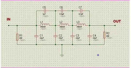

I have built an FPGA based DDS (fc=200MHz. out: 0-50 or 0-80 MHz) . I have a decent DAC output wave and now trying to build an appropriate filter for it ( Fig-1 ). The filter works rather fine but there are 3-4 strange noises there ( I have another question here that I think the solution for each one may help in solving the other one) .

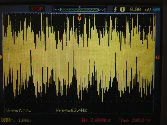

1- Fig-2 50-60 Hz (this may be due to main line but this is 7 volts pk-pk !!!) .
All the upper frequencies drive on it

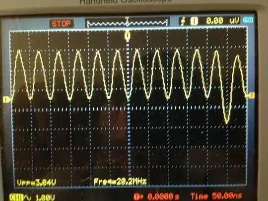

3- Fig-4 Around 50 KHz: this one has steps between cycles and I have never seen anything like that before .

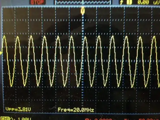

The main frequency ( in this example 20 MHz) drives on to of all of them ( 4- Fig-5 ). This causes that the main frequency jumps up and down on the oscope screen

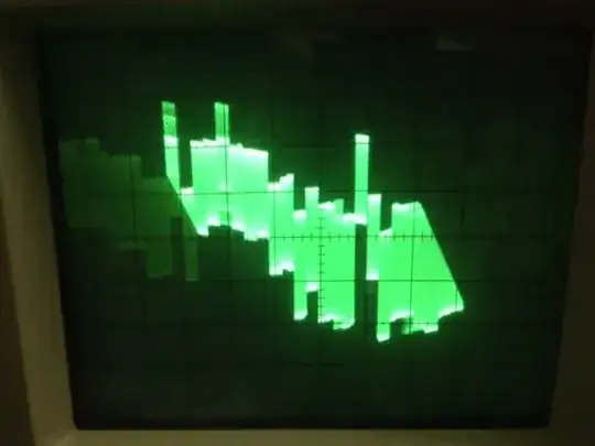

Edition: results with an analog Oscillosciope added at the end ( Fig 7-9 )
Fig-1 The filter:
Fig-2: 50-60 Hz:

Fig-4 50KHz
Fig-5 Main frequency
Fig-6 Up jumping main frequency:
Fig 7- analog oscilloscope: low frequency:
Fig -8 analog oscilloscope: main frequency:
Fig-9 analog oscilloscope: Jitter like behavior seen at fx10 setting:

    One comment : digital sampling scopes can tell lies... at slower scan rates they can sample much more slowly than the "1GHz" or whatever the label says; this can cause unexpected aliasing. I have seen a clean looking 1Hz waveform on a scope fed with a 10kHz (probably 10.001 kHz!) square wave. Can't be sure but that's what Fig.4 looks like to me. May explain figs 2,3 too. Do you have access to a fast analog scope? –  Nov 23 '13 at 13:14

  • 20MHz with a 20MHz fundamental should throw light on the 50/130Hz problems... Fig 6? There may be more than one problem; that could be a logic error for example. You don't say why there are gain and offset differences between figs 5,6. –  Nov 23 '13 at 13:29
  • @BrianDrummond offset is what I meant by jumping up and down! the gain is related to the moment I took the photo. It repeatedly goes up and down and if I captured it in another time it might seem equal to fig-6 ( that's perhaps another lie from the oscope!) – Aug Nov 23 '13 at 13:35

  • @BrianDrummond I added Analog Oscope results. Now I have 2 problems: 1- low frequency aliasing 2- Jitter ( it was not seen in the digital oscope before). which one is lying: the analog ( cheap, 20 MHz and old ) or the digital ( fancy, 2 MSPS and new !!!!) ? – Aug Nov 23 '13 at 14:10
  • Look at fig 7. Looks like a random DC offset, changing at a very regular rate (3.5x per division). What is that rate? That tells you something (I don't know what) about the design. Can you reproduce it in simulation? –  Nov 23 '13 at 15:13

  2. The filter design must be driven from a current source to work as designed with 6dB loss in the passband, since impedance ratio is 1/2. If this is my false assumption,then R1 should be in series with a voltage source.
  3. The values shown are for 80MHz LPF may has 2dB ripple in response in pass band but stopband begins at 100MHz, @ -66 dB. If you don't want the ripple, use, Chebyshev Type 2. The steep skirt as a large ripple penalty in your Cauer design or change the ripple factor.
Suggestion. Learn how to match or isolate output and load impedance so that your test measurement impedance does not introduce a false circuit load. e.g. dont load filter with a 20pF probe. Use 150 + 50 Ohm scope or Spectrum Analyzer or use a 1pF FET probe.

  • Thank you!. Actually, your comment no-2 if combined with more discussion may be an answer for the question I have put its link ( it has an active +300 point bounty now !).In AN837 application note , a Cauer design is recommended for DDS. which one should I select: Cauer or Chebyshev-II ? I have not access to spectrum analyzer. It would be a definite answer to the other question if you could provide a design and part value for such a filter for fclk=200MHz( fc= 0.45 * fclk) – Aug Nov 23 '13 at 16:47
  • Link to the other question: http://electronics.stackexchange.com/questions/91064/how-to-use-input-output-termination-resistors-in-filters – Aug Nov 23 '13 at 16:48
