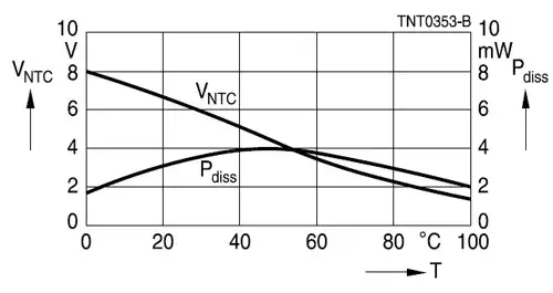

NTCs are non-linear and you'll see rather nasty formulas expressing the relationship temperature-resistance.
Adding a pair of ordinary resistors you can linearize their behavior so that this relationship is approximated by a simple linear equation of the form \$y=ax+b\$. The following example is from this Epcos appnote.
The curve is virtually straight from 0°C to 60°C, which is sufficient for many applications.

  • Don't linearize unless you're using analog-only circuits! – Jason S Jun 18 '11 at 16:16
  • And please edit your post for accuracy: the relationship does not become a simple linear equation. The relationship approximates a linear equation over a particular range of temperatures. – Jason S Jun 18 '11 at 16:17
    Jason: can you elaborate? Why not linearize in digital circuits? – Stephen Collings Jul 16 '12 at 13:44
  • App note says that this configuration will suffer from sensitivity a little. – abdullah kahraman Oct 06 '12 at 08:50
  • @abdullah - Yes, due to the parallel resistor. But if you have 10 V available like the graph shows you have nearly 5 V difference over a 60 °C range, that's 83 mV / °C. Even at 5 V you'll have 41 mV / °C. A 10-bit ADC with a 4 V reference has a 4 mV / LSB resolution, so that's a 0.1 °C resolution even without a difference amplifier or InAmp. I don't think the reduced sensitivity is a real problem. – stevenvh Oct 06 '12 at 09:06
  • @stevenvh Yeah, it's great that you mentioned that. That is a big relief for me. – abdullah kahraman Oct 06 '12 at 09:42
  • Who cannot have money for just 1 resistor? – abdullah kahraman Oct 06 '12 at 09:43
    @abdullah - I meant that ironically :-). But apparently more users seem to prefer the more complex situation, which I don't mind, but then the only reason I can think of to dismiss the more simple solution is that the resistor would too expensive. :-) – stevenvh Oct 06 '12 at 09:54
    I have the same NTC with OP. I've managed to get a 0.1 °C resolution for my Ni-MH battery charger's temperature sensor, with a simple equation. Accuracy is not that great, but eh who needs it. Temp in °C = 83-(x*106/1024). Dividing by 1024 is easy :). Here is the graph. And I only used a 8k2 resistor in series.. – abdullah kahraman Oct 06 '12 at 21:58
