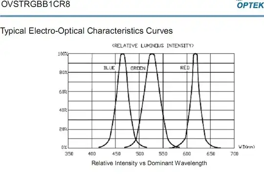

Consider the OVSTRGBB1CR8 PLCC RGB LED

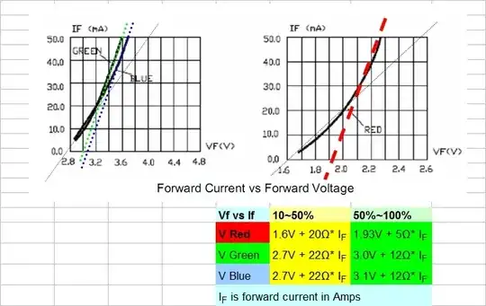

I made a little table now of this LED, which is typical for all RGB LED's but variations exist with P/N and size of chip.
Here you can see the separate voltage V vs I curve. and two linear approximations for low and high current using an arbitrary 50% threshold. The ESR or series resistance, Rs of each LED drops as current increases to rated current.
Note that Vf (blue) = 3.1V + 12Ω * IF [A] for If = 0.025 ~ 0.050 Amp means it has an ESR of 12Ω for currents 25~50mA using a threshold of 3.1V
Since thermistors tend to be much higher resistance values. you can now see it is impractical to use a thermistor to regulate the LED current, but you can amplify a voltage ratio using a thermistor to drive a MOSFET to change the voltage above but that is not very precise. It has been done in cell phones but requires precise awareness of LED VI curves and MOSFET VI curves and their corresponding ESR values.

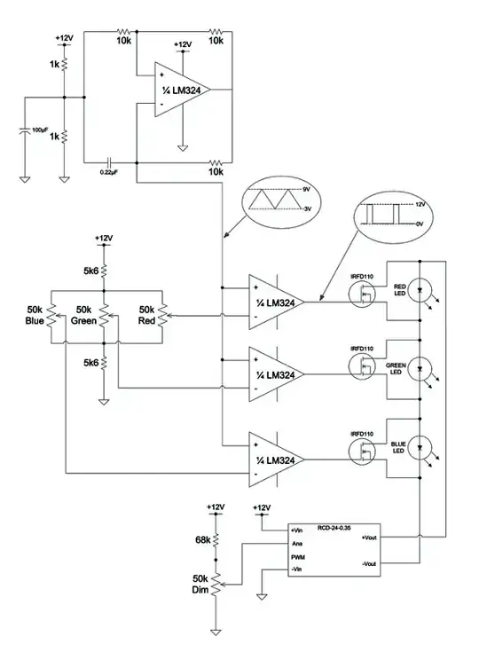

So let's try a more precise method that does not rely on voltage tolerances.
To regulate brightness PWM is the best precise method.
Now to control the brightness using a thermistor instead of a POT you need a "bridge" or resistor ratio circuit to create the voltage you need over the temperature range you choose.
There are many sites and links to show you how to use a thermistor, so I wont duplicate here except to say you need a half bridge circuit with a precision voltage reference.
The module in the bottom is a constant current source which is selected to drive the maximum current and the PWM MOSFET bypasses the LEDS to reduce them to zero current while the entire string stays constant.

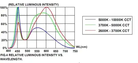

When you drive all RGB discrete LEDs together you also get white to the eye, but the spectrum is narrower, so when reflecting it off objects it will give a slightly different shade or Colour Rendering Index(CRI) than sunlight but for light indicators shining on the retina, it can work. enter image description here
This has nothing to do with your RGB project but it is useful to compare the spectrum of White LEDs with the RGB you are beginning to use.
See in the White LED profiles below how the warm white (3000'K) has more (green & yellow) phosphor added, it absorbs more Blue emission so the overall power radiated is slightly less than cool white. enter image description here
Note that White LEDs are actually Blue LEDs with phosphors to perform wavelength conversion and yield an apparent white colour so they have a similar VI curve.
When mixing RGB colours note that white is not the same although neutral white or 5000'K is close to a cloudy daylight white.
