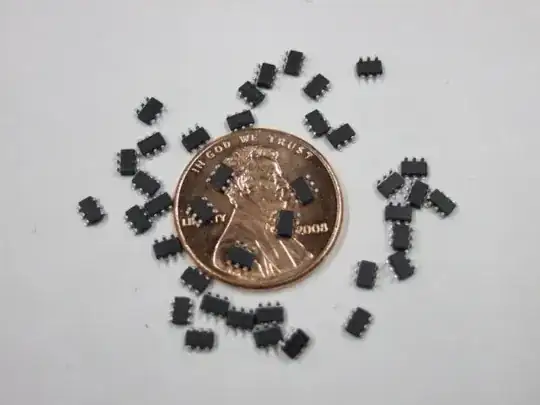

The smallest microcontrollers I know about are the Microchip PIC 10Fxxx series. These come in SOT-23 packages:
Added:
I should have mentioned that these things also come in a 2x3 mm DFN package, but I didn't have a cool picture of those available.
