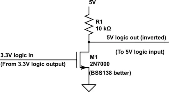

  1. If you can deal with a logic inversion (and don't require active pull-up), a mosfet and pull-up resistor may be used:
schematic
simulate this circuit

  • I think some of your diagrams are labeled backwards. I have a 3.3V logic output and a 5v logic input. I understand how #4 works and can confirm that the label is just backwards (but it is the correct circuit for what I need). I don't fully understand #3 enough to know if it's labeled backwards or is actually backwards. That being said if I use two instances of #4 to keep the logic non-inverted I should be good to go. – Huckle Sep 15 '13 at 19:26
    The labels aren't backwards. "3.3V logic in" indicates it is an input into the circuit I have provided ... of course it is from an output from your circuit. "5V logic out" then merely indicates that it is an output from my circuit to your 5V logic input. I will edit to clarify. – Tut Sep 16 '13 at 10:14
  • It makes sense now that you explain it, but it's backwards from the conventional point of view (where conventional point of view is meant to mean point of view of someone interfacing digital ICs). Thanks again. – Huckle Sep 17 '13 at 05:56
    @Huckle: Tut has provided a circuit or module to be used to interface two other circuits. The standard is to label the terminals or interface points from the point of view of the circuit show - not the ones you can't see. You connect your outputs to this circuit's inputs. Sometimes we need to indicate where to connect on another circuit but use arrows in those cases so it's clear. – Transistor Jul 23 '16 at 18:21

  • @Tut got it, thanks a lot. I was testing it out myself and I could not figure out what D1 was for haha http://tinyurl.com/n975z7q For my little project, I ended up using 2N7000. It was very straightforward to use. – wbkang May 24 '17 at 03:36
    @wbkang ... Good choice. Option 3 is not the "holy grail" of level conversion. It needs to be carefully applied with proper choice of both resistor and diodes (good of you to simulate). The mosfet solution is better if you can live with the logic inversion and the slight added cost. – Tut May 24 '17 at 10:39
