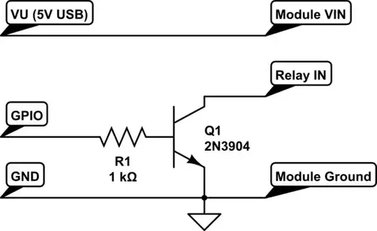

Simple, with a standard NPN transistor. You could also use a 3.3V mosfet, but an NPN what you need.
schematic
The Relay Module will be powered from the same USB power supply needed for the mbed board.
The Module has an optocoupler that needs to be pulled low at Relay IN to enable the relay. The transistor is enabled by a GPIO HIGH.

  • Ok, this looks great as I have a 2N3904 to hand! I have a question. If it is the voltage which needs to be boosted, why is the voltage line directly connected to the VU and the GPIO line regulated? The GPIO pins are 5V tolerant, so I thought that they would have no issues. – bladepanthera Jul 31 '15 at 15:41
  • @bladepanthera if the gpio you need control the module is 5V tolerant, you still wouldn't be able to control it properly. While the pin wouldn't be hurt by 5v IN, when it is HIGH it will still only be 3.3V, and that means the relay control optocontroller will still be ON. You could never turn the relay off. – Passerby Jul 31 '15 at 15:51
  • @bladepanthera the VU line is 5V USB. The Relay needs 5V to trigger. The control side of the module could work with a lower voltage, but would require having two voltage supplies, and modifying the board. Trust me, this resistor + transistor setup is needed for multiple reasons. – Passerby Jul 31 '15 at 15:53
  • The relay turns on and seems to have enough power through the transitor which is great, but now when I try to turn the lamp on and off by sending 1/0 signals to the pin it is connected to, the lamp doesn't change. It turns on initially when the relay is powered on and stays on all the time. Any ideas? (Using this example code - pretty basic!) – bladepanthera Aug 03 '15 at 15:08
    Ok, forget it! It works now :D I had it connected through the pin that I was using for the lcd board on the mbed expansion board! Works like a charm. Many thanks! – bladepanthera Aug 03 '15 at 15:13
