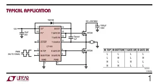

For half bridge just use one of these: -
For full bridge use two. These devices are able to drive n channels topside because they smuggle a bit of energy away from the output using a capacitor \$C_{BOOST}\$. The 1N4148 is for startup I believe.
There are other devices that can do this too.
Andy aka

    Use of 1N4148 explained here : http://electronics.stackexchange.com/questions/79257/need-help-choosing-h-bridge-driver?rq=1 – ths1104 Oct 03 '13 at 11:32
You should Use IR2101, Its a half bridge gate driver IC with all the details mentioned inits datasheet. Its very useful.try it.
