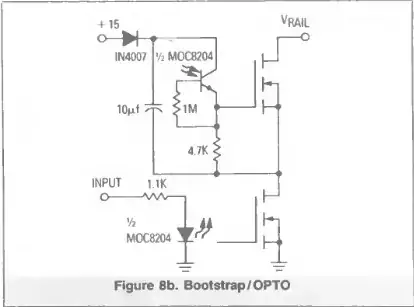

I have no idea why you're given "Infra-red Detector" and "Infra-red Emitter" but if by any chance that means you're given optocouplers, you could also do this:
