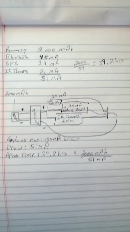

So I am attempting to determine if the battery I choose can power the devices I need. This is my first day doing anything with ohms and current and such. So go easy.
I have:
2000mAh battery
45mA Bluetooth card
3.9mA GPS card
2.0mA IR Thermometer
Now the arduino mini only says that it has a max output of 150mA so I don't know how much it consumes. For this example I am disregarding it because if I am right then I have a ton to spare.
So based on my thought process I think I get 2000mAh/51mA = 39.2 hours?

The way of your calculation is basically correct.
Of course, the devil is always in the details. Normally, one calculates a "typical" outcome, and a "worst-case" outcome. For those calculations, you'll need the "typical" and the "maximum/minimum" figures from the data sheets.
A few factors to consider:
  • the battery might have a capacity of 2000mAh when new, but this will most probably go down as it ages,
  • the battery capacity highly depends on the temperature; if you want to use it only at room temperature, it might behave much better, but outside at -25C degrees, the capacity might be only a fraction of the normal,
  • the consumption of the components might as well change depending on the temperature,
  • the consumption of communication peripherals usually highly varies according to the state of the communication (active, waiting, standby, etc).

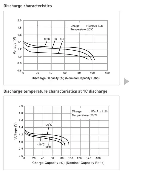

I recommend to refer the discharge characterstics. Discharge characterstics vary with tempearture, amount of charge.
I am not sure what type of battery you are referring. a example datahseet can be. http://industrial.panasonic.com/eu/i/21291/Handbook2011/Handbook2011.pdf
Sample discharge charactersics will be of this form. enter image description here
As battery discharges it's voltage will be reduced, i am not sure what is the minimum voltage required to proper operation of your circuit. All these factors needs to be looked, when deciding how many hours a battery can power the circuit.
This post has more information Does mAh measure how long a battery would last?
