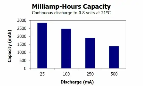

Consider the datasheet for Energizer AA cells. A chart is provided which shows you the various milliamp-hour capacities at various loads:
AA Battery mAh Depletion Chart
If you continually power a device with 25 mA, the cell will have approximately 2750 mAh. If you divide this current into the capacity, 2750/25, you get the number of hours that the battery can sustain it: 110. If the load is 500mA, the cell's usable capacity actually drops to approximately 1500 mAh, and 1500/500 is only 3 hours.
Devices like remote controls do not use continuous power. They spend most of their time in an idle or "sleep" state, and consume power only when you press a button. In those cases, cells will continue to be viable and power the device for a very long time. The milliamp-hour capacity chart is based on usage, not on idle time.
Environmental effects and physics will erode the chemistry in a cell even when it isn't being used. The datasheet assumes you are working with fresh cells and within certain environmental conditions.

    "Even though milliamp-hours is often treated like a finite amount of energy" suggests that maybe $mAh$ is a unit of energy, but it's not. Also, at higher rates of discharge, you do get the full capacity, but you get it at a lower voltage. Note that the graph says "discharge to 0.8 volts". – Phil Frost Aug 17 '13 at 10:53
  • I should probably change "energy" to "charge" for accuracy. I'm not sure I understand/agree that the full mAh charge is available at higher discharge rates. The cell discharges and its voltage lowers at any discharge rate, but it's a matter of how soon that occurs. Isn't it true that a higher discharge rate decreases the efficiency of the cell and therefore total mAh capacity is reduced? – JYelton Aug 17 '13 at 10:59
  • Not really. There is so much charge separation in the battery, defined by the chemicals in it and the quantity of those chemicals, and the charge can't go anywhere else. At a higher discharge rate, the voltage at the terminals decreases, and can drive the charges less quickly, but they are still separated. You just might have to wait longer for them to un-separate, and you will have less voltage available at the terminals, and thus less electrical energy. – Phil Frost Aug 17 '13 at 11:01
  • Also: Charge conservation. If you also consider that the battery has no self-discharge (valid only for some battery types, I suppose) this is how you conclude all the charge must go through the load. If these is self-discharge, then there's a point at which lower discharge rates are less efficient, because most of the energy is lost to self-discharge. For alkaline batteries however, self-discharge is very low. – Phil Frost Aug 17 '13 at 11:09
  • @Phil Thanks for the clarifications. I've added some more to my answer per your comments. – JYelton Aug 17 '13 at 11:14
  • @PhilFrost Your August 2013 comments here state that you still get "full capacity " from a battery at increasing discharge rates. This is not the case for essentially all practical battery chemistries and batteries. The gross amp-hour capacity decreases with increasing current and the Watt-hour capacity also decreases. eg a battery rated at say 10Ah at C/10 rate will give progressively lower Ah capacities at higher currents AND the same applies for gross delivered Watt-hours whether at constant or variable Watts - higher rates give lower capacities. .... – Russell McMahon Dec 03 '14 at 00:29
  • .... While this is slightly complicated by eg constant current loads or constant power loads or constant resistance of whatever, the result is consistent - a load which increases rate of depletion also decreases available resources. | Mechanisms vary and interact. Internal resistance causes higher % internal losses at increasing I and may also increase more rapidly due to chemical-mechanical effects. Secondary reactions may occur at greater rates. | A 'confounding' effect is that at very low rates "self discharge" will use increasing amounts of available energy, but this is a secondary factor. – Russell McMahon Dec 03 '14 at 00:33
