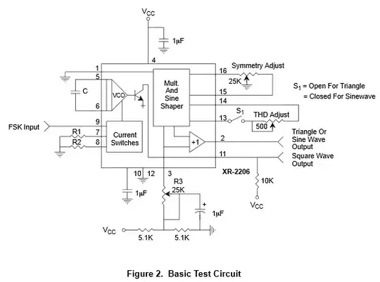

The XR2206 works just fine off a single supply without any kind of rail splitting, you just need to read the datasheet. Figure 2 shows a single supply example.

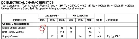

If you go this route, be mindful of the minimum single supply voltage.

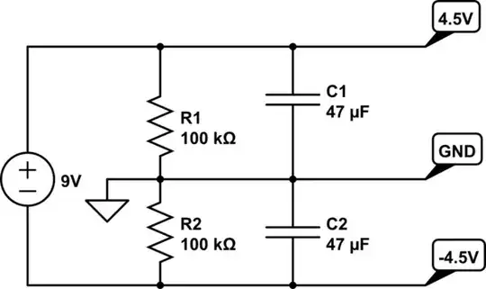

For a quick and simple dual power supply, use two resistors in series connected in parallel with two capacitors. Connect the two ends to the battery or power source and BAM! You have a dual power supply. Typical values for bipolar converters like this are 100k-1M for the resistors and 47uf to 4700uf depending on the current draw of your circuit.
Note:!!! Make sure the negative rail of your power supply is not connected to ground! Use the continuity setting on your DMM to check !!!

4Add a voltage follower opamp / unity gain to your circuit and you'll probably turn it in an upvoted answer. – jippie Aug 17 '13 at 19:48
1@jippie The buffered voltage divider is already covered in my answer. – Anindo Ghosh Aug 18 '13 at 03:13
6This actually works really well to power a part. I've used these to power (approx) +-15V rails at 30W with less than 100mv voltage droop in the past. I was using something like 47mF caps. Is it a good design? - Nope! But it does the job if you are in a pinch and it's all you have on hand. – OhmArchitect Aug 20 '13 at 22:28
1@OhmArchitect No. I can't work well to power a part. Indeed, you may be able to draw some power for a few ms without the rails dropping too much, if you have enough capacitance. But if you draw significant power constantly and if the power drawn from both rails is not symmetrical, you'll see your mid-rail quickly moving away from the middle. Especially with resistors as high as 100k. – dim Jul 22 '16 at 12:27
Decuplage capacitors are not needed at all. resistors are fast enough to prevent ripples, trust me! – pylover Mar 11 '20 at 15:24
@OhmArchitect As dim says, once you start drawing current, your "GND" line will no longer be half way between 4.5V and -4.5V. There is no way that you could be drawing 30W through GND with a +/- 15V supply rail. The current through R1 must be only 0.15mA - nothing like enough for a 30W load. The only way (and it is really bad as it is very power hungry) that you could have anything like a stable supply for general powering of circuits is to have small resistors for R1 and R2. Then any additional current drawn by GND will not have a significant impact on the voltage drops across them. – Dave Oct 08 '21 at 15:16
