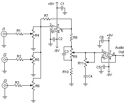

Here is the circuit in question:
(Source: http://www.aaroncake.net/circuits/mixer2.asp)
As one can see, it requires +9VDC, -9VDC and GND. I've never built such circuits that have negative potential (I know it is relative). Wondering if someone can help illustrate / explain, if it is possible to power this somehow using a 9VDC wall-wart ?

You will probably find that two 9V wall warts will do the trick - connect the positive output from one to the negative output from another - this connection is the "new" 0V and you'll have +9V and -9V available - regard it as two 9V batteries in series with the middle (common) connection being called 0V.
Because wall warts produce isolated output voltages, they can used like this but always double check with a meter first to ensure everything looks and feels OK.
Looking at your op-amp circuit you should be able to get aways with a single 12V wall wart and a rail splitter made by two resistors across the supply. The junction of those resistors will be 6V up from the negative rail and ALL the points marked with an "earth" symbol on your circuit can connect to this point. This is a much used technique but, as always, it won't suit every target circuit but looking at your circuit it should be OK.
Andy aka
  • 456,226
  • 28
  • 367
  • 807
  • This the kind of trick I was hoping to see. The 12VDC wallwarts are aplenty in my bin and definitely avoids putting two 9VDC wallwarts together, making the circuits larger than it needs to be. – bdutta74 Dec 29 '15 at 10:55
  • Cool. Redraw your circuit with what I've suggested doing and add it to your question as an edit section - just so I can double check. It's easy to get this wrong and lose faith should you forget something! – Andy aka Dec 29 '15 at 11:04
    It's a not a virtual ground (despite seeing this term used this way) it's a mid-rail generator. In the OP's circuit there won't be much current injected into the potential divided mid-rail but that depends on the feedback resistors on the three front-end op-amps so a certain care should be taken on this just using a mid-rail voltage divider. This is why I suggested a redraw and re-check. That injetced current can make the mid-rail a little offset from tru mid-rail and noise can also appear on it. Some folk will buffer the mid-rail with a unity-gain op-amp because of this. – Andy aka Dec 29 '15 at 11:53

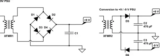

If you have a transformer-based PSU available you can probably convert it from single to split-rail as shown below.
schematic
Note that each rail is now only half-wave rectified so I'd recommend some large caps or voltage regulators to eliminate hum.
If you want to keep a standard jack on the PSU then convert it to an AC PSU by removing the rectifier and capacitors and put the diodes and caps into your project case.

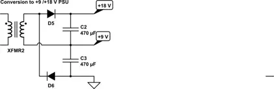

This configuration can also be used to make an 18 V PSU.
schematic
