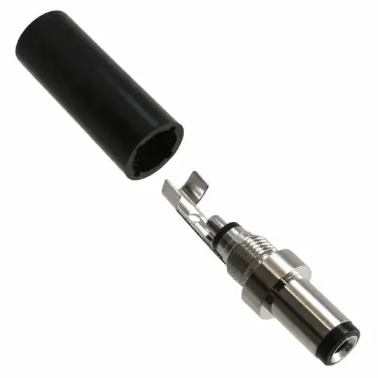

I got this power barrel plug. http://www.digikey.ca/product-detail/en/PP3-002A/CP3-1000-ND/992136
It doesn't have any hole for me to put a wire through. The wire just goes into the hole for approximately 0.5cm. How am I suppose to solder this? I also tried crimping it, but it flatten the tube and causes the centre pin to touch the bottom pin.
Also I found it really hard to solder even on the bottom pin as the solder doesn't really stick to it.
I wonder if anyone could give me some suggestion on how I can attach wires onto this barrel plug.

Tin both wire ends first. Fill the middle cup with solder, and stuff the (stripped) positive wire in while the solder is hot. Push the negative wire through the hole from inside to outside up to the insulation, and solder the wire to the outside of the contact towards the plug. Crimp the arms around both (insulated) wires. Screw the cap on (and oh yeah, don't forget to put it on the wire before soldering anything).

I admit that this type of plug is almost impossible to solder well. The center pin is not much of a problem, just strip a very short patch of one wire (center wire of course, if you have a coax-style cable) and solder it.
For the outer tab you can heat it for some time until solder flows over the desired place, then press the pre-tinned wire onto the soldered part and let it merge.
The alternative is to fold the unsoldered wire back to the clamping flaps, and solder it to the flaps. Then you can crimp the flaps if you want, but they are too flimsy to add much mechanical strength.
You can also try to crimp the flaps over the wire and not solder it, but I think that will not be reliable in the long term. Crimping and then soldering is likely to melt the isolation of the wrong wire too.
But the best alternative is to forget about using this type of plug. Get a prefitted plug+wire (there are some sources), or salvage a leftover wallwart.

Firstly, you need a holder like a "helping hands" with two alligator clips to hold the barrel plug and the wire in position so that you can concentrate on manipulating the solder wire and the iron.
Even if there is no hole for the center conductor wire to go through, it can just be brought into contact with the terminal and soldered on.
Prior to bringing in the wires, coat the plug's contact surfaces with solder.
The issue of the solder not sticking should be overcome by fluxing the plug's contact surfaces liberally, and using a higher wattage unregulated soldering iron (40W to 60W rather than your 20W used for PCB work), or cranking up your regulated iron.
Larger parts like plugs have a lot more thermal mass that sucks away heat, which in turn lowers the temperature at the tip and extends the time required to make a joint.

I always cut the crimp flaps, solder the wire on the flat part and cover it with heatshrink. I used to assemble guitar pedal boards so i have done a few of those.
