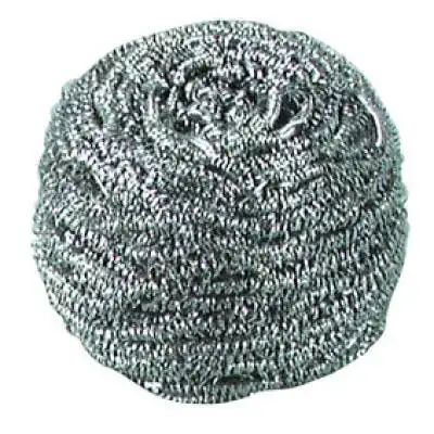

A much cheaper option than the metal shavings coated in flux, is to put a pan scourer like this one:
Pan scourer
(source: hospitalitywholesale.com.au)
in a small container, and use that to clean the excess solder off of the tip, it seems to do a reasonable job and doesn't cool the tip excessively. Although you don't get the benefit of the flux which coats the shavings either.
(A tip: make sure that the scourer isn't plastic!) ;-P

    Make sure you don't use a steel wool based scouring pad, or you'll damage the tip of your soldering iron, and get rapid oxidization as well. Must be brass! See this one: http://www.elexp.com/sdr_3460.htm, which comes in a weighted metal container with a rubber bottom for $5.75, replacement cleaners for $2.95. – Kevin Vermeer Jul 15 '10 at 17:48
    Copper works fine too. I wonder about aluminum, maybe that would not be a good idea as aluminum oxide is quite hard. – jms Feb 02 '16 at 19:46
  • Whoa, elexp.com charges more for the shipping than for the products, in quantities that small. Sparkfun offers slow cheap shipping for the same things. – Camille Goudeseune Dec 21 '16 at 20:45
