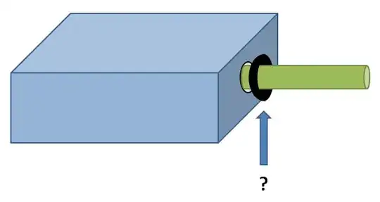

Suppose I would like to insert data-cables of varying diameters -- e.g., a cable of 5 mm diameter -- into the 6 mm diameter hole of a plastic enclosure. The wires within the cable are terminated via soldering to a PCB inside the enclosure.
What methods are used in the industry to ensure that pulling the cable won't make it slide in and out of the enclosure (thus preventing damage to the wire connections to the PCB inside)?

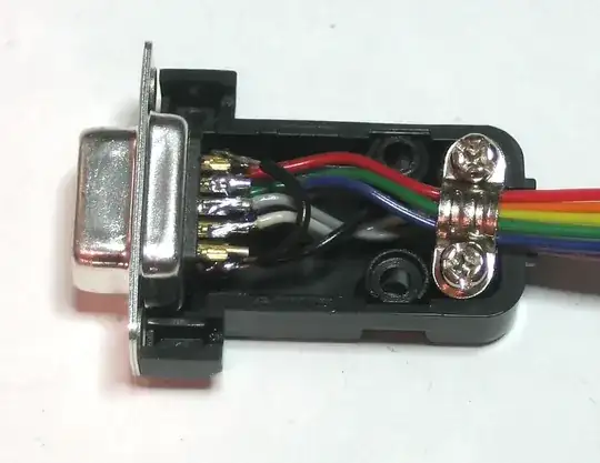

Similarly, but less often seen now in the days of cheap molding or diy kits, is this. The cable is screwed into a holder which is prevented from moving in OR out by the case and screw posts. enter image description here

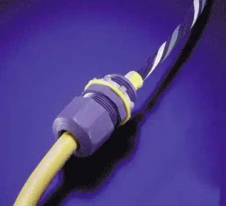

The third is through the use of Cord Grips or Cable Glands, also known as grommets. Especially is a water tight fit is needed.
They are screwed on, the cable past through, then the grip part is screwed. These prevent the cable from moving in or out, as well as sealing the hole. Most can accommodate cables at least 80% of the size of the opening. Any smaller and they basically won't do the job.
Other options include cable fasteners or holders. These go around the cable and are screwed or bolted down (or use plastic press fits). These can be screwed into a pcb for example.

    Nice comparison of the various methods. The cable fasteners seem like a convenient way to do it, as long as the PCB is designed keeping in mind the allocation for the screw. One hurdle being to find one of the exact diameter allowance. For anyone interested: Found a page listing various fasteners: RS Electronics – OrCa Jul 31 '13 at 04:01

"Strain relief" or "cord grip" is the magic phrase for Google you are seeking. Here's a selection from McMaster-Carr:
strain relief fittings
Cheaper devices might use gobs of glue or knots in the cord, in combination with a simple grommet, depending on the anticipated stress, cost, safety, and regulatory requirements.

    Strain Relief isn't the same as a cord grip. Strain Relief is to prevent damage from bending at a sharp angle. – Passerby Jul 31 '13 at 02:41
  • The webpage states: "As you tighten these fittings, they compress to grip your cord, preventing pull out." In practice, how strong have you found this fit around the cable to be? Clearly these cord grips seem to be least a flexible solution, given that they would fit cables of various diameters that exist in my case. – OrCa Jul 31 '13 at 02:42
    @OrCa for the good ones, usually the relief is stronger than the insulation to which it attaches. If you anticipate more strain than that, you should really be using a cable or assembly designed with a structural member incorporated like a steel (non-electrical) cable, which you can then bolt to your enclosure using ordinary hardware. – Phil Frost Jul 31 '13 at 02:45
    @PhilFrost You would also notice that all of the results in your search are called "Cord Grips", not strain reliefs. – Passerby Jul 31 '13 at 02:48
    This is a correct answer showing correct stuff (all the way to UL approval). Yet, somebody seems to have downvoted it. – Nick Alexeev Jul 31 '13 at 03:23
