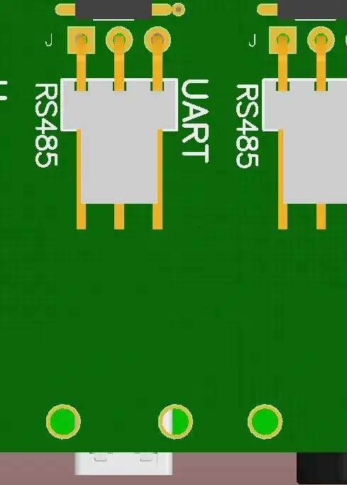

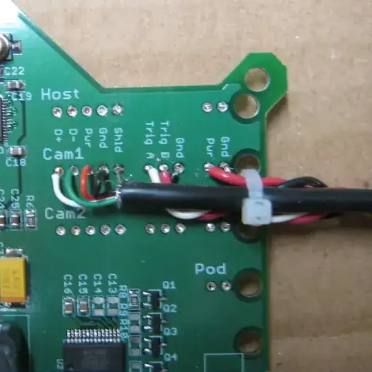

Zip ties are a good way to provide strain relief for cables attached to a PCB. You lay out a path for the cable on the PCB, and put adequately large holes on either side of this path for the zip tie.
I've done this many times on custom assemblies in which using a connector would have been counterproductive.

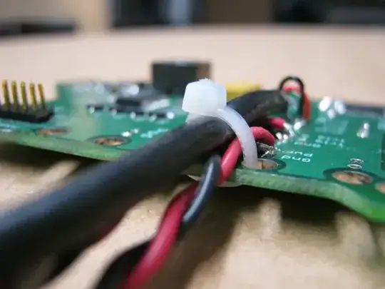

Here's one example. It's a board that functions as a "hub" among several different devices in a cramped aerial photography pod. Each device requires a USB connection, a power connection and/or a control connection. The wiring for one of the devices is shown installed. Adjacent zip ties share the same hole.
top view
side view
Dave Tweed

  • I also like this solution, and already considered it. I would place it at a good 2nd place after using a metal plate and bolts though, in terms of durability. In 1st place in terms of easy of installation though. – K0ICHI Oct 29 '19 at 15:10
  • If you want additional durability, you may pass the individual wires through an additional hole (unplated) before bending them back to be soldered to a plated hole (forming a "C" or a partial "S" curve). This is a form of strain relief, but increases the installation difficulty. The NPTH should be sized slightly larger than the diameter of the insulation, allowing free movement, but "catching" if it is pulled.This looks very similar to this example, but there are two rows of holes (one plated and one not plated) per connection. – crasic Oct 29 '19 at 21:50
  • @crasic: see the link in Gallifreyan's comment. Not really relevant to my answer, though. One or the other of you should write that up as a separate answer. – Dave Tweed Oct 29 '19 at 22:08
  • I'm just suggesting to combine your approach with an extra loop to avoid any chance of pulling on the joint in the case the zip tie loosens or cable slips, the link in the other comment has another additional loop on top of that. – crasic Oct 29 '19 at 22:43

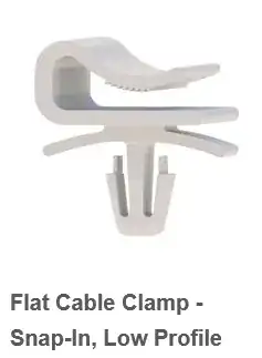

Cable ties are great. Just put two through holes in the PCB away from the connector.
Enter image description here
There are also a variety of flat tie holders that can also facilitate zip ties. These can be pushed in or fastened with fasteners.
Snap-in cable clamps (many different varieties) can be used in PCBs with one through hole.
Source: Flat Cable Clamp - Snap-In, Low Profile (Essentra Components)

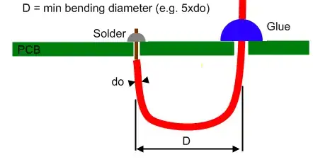

One very simple technique used on spaceflight PCBs (and thus good against vibration) for a small number of cables is to insert the wire through one hole, and solder the stripped end at a distance from that hole corresponding to the minimum bending diameter of the wire (which may be assumed 5 times the outer diameter if you do not know it). A spot of glue (epoxy or hot glue if not available) is then added to relief the solder from mechanical stress.
The minimum bending diameter is not only chosen to reduce the footprint on the PCB, but also to ensure the wire has some curvature inside the glue: if the wire is straight, since wires are often insulated with PTFE which has very low adhesion to most glues, the wires would have very low resistance to pulling.
