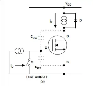

In the IR document, they are driving the gate with a constant current. See the test circuit:

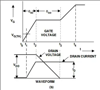

That is, they are delivering a constant amount of charge per unit of time. That's why they have the same shape: if charge is a linear function of time, then they are basically the same graph.

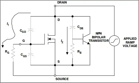

Notice that the flat spot on the gate voltage graph corresponds to the period where the drain voltage is decreasing (\$t_2\$ to \$t_3\$). Perhaps the best explanation of what's happening here is the next chapter in the IR document you reference, the section on \$dv/dt\$ capability:
Here, they are showing what happens when the drain has an increasing voltage ramp applied. But, this works in reverse, also. When the drain voltage is going down, there must necessarilly be some current in \$C_{GD}\$, in the opposite direction. This is because, as with all capacitors, a change in voltage must be accompanied with a current:
$$ I = C\frac{\mathrm{d}V}{\mathrm{d}t} $$
So as the MOSFET begins to conduct, and the drain voltage begins to decrease, some of the current from the gate driver must go into \$C_{GD}\$ to decrease its voltage. This is current that can't be going into \$C_{GS}\$ to increase its voltage. Thus, for as long as the drain voltage is going down, the gate voltage barely increases.
At \$t_3\$, the gate driver has managed to get the drain voltage about as low as it can go. After this point, the drain voltage doesn't decrease much with increased gate charge. Instead, you get a relatively slow decrease in channel resistance. So now the charge going into the gate is free to go mostly into charging \$C_{GS}\$, and the gate voltage can rise rapidly again.
