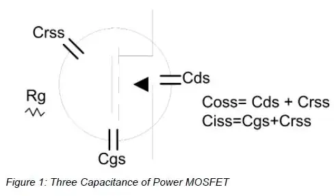

You're being confounded by Cgd (same as Crss). Two main points:
  • Cgd is very dependent on Vds.
  • Cgd gets swept through Vds-peak + Vgs-peak. Not just Vgs.
First, look at Figure 11 and Cdg. Note that at Vds = 25V, Cgd is the tabulated 220pF. But what is it at 5V ... 700pF. And what is it at 1V ... ~8000pF. 18nF not looking so unreasonable now.
So, to get the 185nC number in the datasheet, as shown in Figure 10, you would have to integrate Cdg from 125V to 0V + Vgs-peak, and then add the Cgs contribution.
Also relevant, 66660 and 74867.

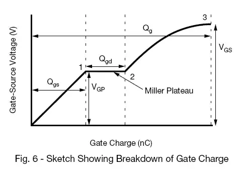

You're missing that the gate charge is specified at Vd = 0.5Vdss = 125V. The charge on Crss must also be supplied through the gate. I suggest reading this Vishay application note:
Power MOSFET Basics: Understanding Gate Charge and Using it to Assess Switching Performance.
The below diagram is taken from there.
In this case:
Qg = 185nC
Qgd = 80nC
Qgs = 50nC
