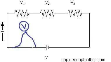

I have a series circuit. Let's say the battery has a potential difference of 10 Volts.
On two points of the wire before the current hits any resistors, I attach the readers of a voltmeter. Since there is no resistance, and the formula for voltage is V = IR, does this mean that the voltage would read zero in between those two points?
But how can this be - we know there is 10 volts of current flowing through!
The example my teacher gives is that electricity is like a running river. The voltage is the force of the running water. Pile rocks in middle of the river and this is the resistance. But if you don't pile rocks and measure at two points, that doesn't mean that there is no power (read: voltage) in the river's flow.
Can someone please clarify?
