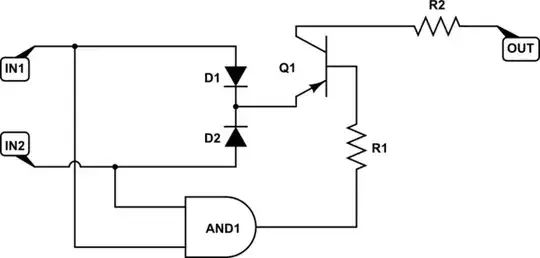

When working on silicon design (Not really on the silicon phase yet but circuit design) I noticed that the XOR gate seems overly complex.
Why would this not work:
schematic
I was was led to believe that the resistors were required for high frequencies to drain the circuit before next clock pulse.
I am new to this so if this is horribly wrong please correct me.

    @Xeno Are you trying to build an RTL (resistor-transistor logic) or DTL (diode-transistor logic) computer? When you write, "hyper reduced fully functional* RISC archatecture", I see fully functional* and see a lot of work ahead of you. Especially if this is the level where you are starting. Not meant as a criticism. I say "go for it." But it is an observation and I think you may need to steel yourself for the work ahead. – periblepsis Feb 16 '24 at 05:03
    As it stands, this is horribly wrong. Perhaps you should write down some basic requirements, such as what the input and output signal levels are. It currently looks like the inputs are voltage (or current?) sources, while the output is current sink? How is that supposed to work? – Dave Tweed Feb 16 '24 at 05:20
  • You might look here for some standard CMOS implementations, and here for some discussion on some key points about what makes a family of logic gates suitable for building larger circuits. – Dave Tweed Feb 16 '24 at 05:28
  • When working on silicone design Sorry, you're not working on silicon design. Silicon design is designing chips. You're working on circuit design. I suggest you head over to homebrew logic and CPU pages on Hackaday. I highly suggest starting with Yann Guidon's (YASEP's) page: https://hackaday.io/whygee – Kuba hasn't forgotten Monica Feb 16 '24 at 05:34
  • @periblepsis I have already worked out the archatecture and have developed an assembler for it and wrote the compiler, it has 16 instructions with full functionality. About the resistors i was led to belive they were necisary to operate correctly... – Xeno Feb 16 '24 at 06:18
  • @Xeno If you have muxes, you don't need specific gates :) So perhaps work out a good mux element, and you can have any gate you want. – Kuba hasn't forgotten Monica Feb 16 '24 at 06:42
  • and wrote the compiler Compiler of what language? – Kuba hasn't forgotten Monica Feb 16 '24 at 07:06
  • @Xeno I've done CPU design for decades. Built my first from 7400 series parts and wire-wrap. Worked at Intel on the BX chipset. And I learned C working on the Unix v6 kernel code in the mid 1970's. But seeing you at this level of RTL/DTL questions gives me some pause. I guess I'll just take your word that this is the only issue faced and that I simply misunderstood how much is ahead of you. Best wishes, then! – periblepsis Feb 16 '24 at 07:34
  • @periblepsis Thank you, I'm mainly strugeling with some of the transistor logic, as I am pretty new to it (I did study it some a few years back but recently picked it back up for this need), the XOR gate was the one I've had the most truble with, but I think I have figured out how to solve it. – Xeno Feb 16 '24 at 16:29
There are a number of problems with this implementation.

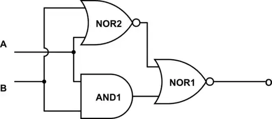

What silicon process is this going on to? Implementing bipolar transistors resistors and diodes on a CMOS process is not area efficient you will probably find that this takes more silicon area than a conventional xor made from FETs. Below is a 10 transistor 'conventional' xor, note and1 and nor1 are a combined 6 transistor and-nor gate, your and gate alone is 6 transistors.
schematic
Although the design may do xor it has no gain. When you design a cell for a large design it is necessary to be able to characterize it for propagation delay and drive capability. This allows you to ensure that your design will meet its timing requirements with a reasonable amount of effort. The timing of your cell will be overly sensitive to the drive capability of the preceding cell and the type of load put on the output.
The cost per FET today is very low the big problem is power dissipation. This circuit will use far more power than a CMOS implementation.

  • i am trying to find an efficent XOR for a micro-proccessor and i dont understand how it is larger than the current XOR implimintation. The reason i post it is because is seems to be smaller, perhaps i have not found a decent one but when i broke it down and optimized (as far i I can understand) to raw silicon it aperes smaller usingm. – Xeno Feb 16 '24 at 06:15
    On which silicon process? – RoyC Feb 16 '24 at 07:02
  • Czochralski process, at least that is my goal. – Xeno Feb 16 '24 at 16:26
assuming series resistor should be a pull down this circuit will do XOR it will however do it better with the PNP transistor the other way round.
Also The output amplitude will be less than the input amplitude so some buffering is needed.
Other circuit designs use more parts to make them faster, stronger, or more energy-efficient.

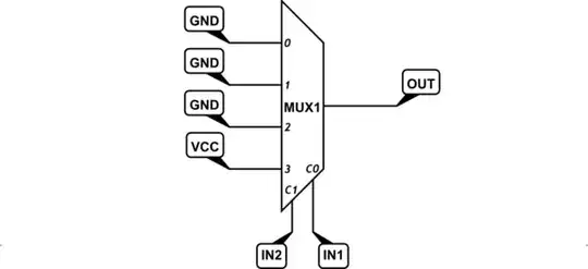

At the most basic level, every gate implements a truth table. So, at a minimum, you could just have a programmable truth table, and you can get any gate you want. All you need then is a multiplexer:
schematic
As shown, the gate is configured to be an AND gate. The inputs 0-3 to the multiplexer are related to output values in the rows of a truth table. So, take the output column from a truth table, stick it into the circuit above, and you have a gate or any other logic function according to that truth table.
It is not particularly complicated to have a simple diode-transistor implementation of such a mux.
The 4-input multiplexer connects output to one of the inputs that are attached to either supply rail, so it always regenerates the signal.

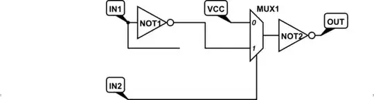

With two inverters added, you can use a 2:1 mux instead:
schematic
simulate this circuit
With a 4:1 mux, we had 4 inputs, and 2 choices of signals to feed to each input - VCC or GND (logic high or low). 2^4=16 possible gates.
With a 2:1 mux, we have 2 inputs, and 4 choices of signals to feed to each input: VCC, GND, IN1, not(IN1). 4^2=16 possible gates.
As shown, the configuration for both mux-gates is that of an AND gate.
Inverters are easy, and a 2:1 mux is not particularly hard either :)

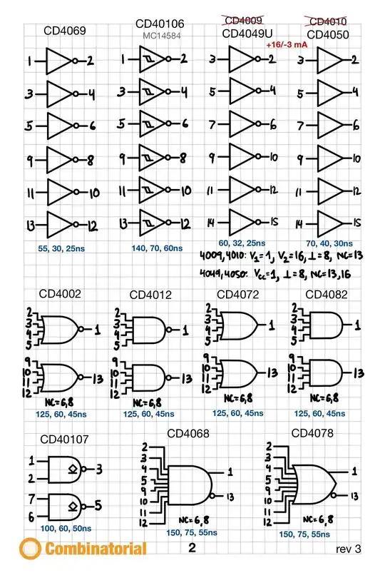

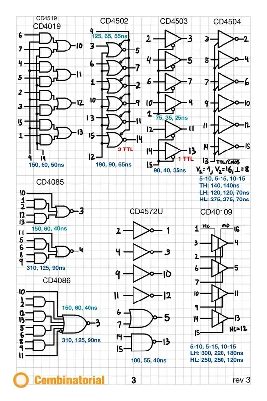

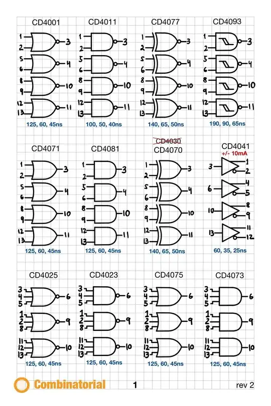

If I were you, I'd use off-the-shelf CD4000-series gates that you can buy from major vendors (DigiKey, Mouser, etc.), and also directly from TI (Texas Instruments), in either DIP or surface-mount packages. Every common chip in that family that has 14 or 16 pins is still available in DIP, brand new!
Below is the collection of the basic gates from the 4000 series, drawn myself. CD4049, CD4050, CD40109, CD4504 are level translators and you wouldn't need them. The processor made of these can be tuned for clock rate vs. supply voltage, just like desktop CPUs, and for the same reason. The higher the voltage, the faster it can go. CD4000-family can be slow and sip power at 3V, or rather zippy at 15V. With the chips of recent manufacture (last 15 years or so), peak speed is between 12V and 15V, with minimum gains from 12V up.
enter image description here enter image description here enter image description here
