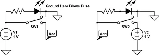

    There is in fact a LED, which is embedded into the very tip of the switch. OP has managed to light the LED before. – Kaz May 20 '13 at 13:28
    So, the LED is probably across one side of the switch. In one position, there will be a short across the LED. OP perhaps only tested with the switch in the open position. Solution: swap the wires to the switch, put battery on left throw of switch (I suspect the diagram has it wrong up there). – Bobbi Bennett May 20 '13 at 14:45
I apologize for posting a speculation as an answer.
The symptoms of this problem imply that the diagram is wrong, the switch is not as shown. Swap the red and black wires at the switch.
schematic
On the right, Acc is switched between Battery and Ground.
On the left, Battery is switched between Acc and Ground. The circuit on the left behaves as you are describing, it is my best guess as to what is going on.
No resistor is needed for this LED, as you have shown by testing it with 12V.
