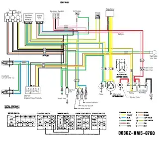

After looking at the wiring diagram, I've figured out how to connect the switch.
ATV wiring diagram
Click for larger view
When I install the switch like this, the ATV powers up.
Switch Connected No Ground
However, when I ground the switch so the LED will light...
Switch Connected With Ground
The fuses blow.
If I don't connect the ground and I connect the pink and black wires to the switches Ground terminal, the LED lights but the ATV is not powered up.
How can I connect the switch so that it turns the ATV on, and the LED on the switch itself also lights?

  • What happens if you don't tie Bat3 to Bat1, and Bat4 to Bat2? I think that may be the problem. – Passerby May 11 '13 at 04:58
  • I've tried that as well. That's how I originally started out, simply making contact between red and black. – Tester101 May 11 '13 at 12:14
  • I mean that Bat 3 and 4 should be switched, but separately. Those seem to be the accessory lines. Like a car has off, acc/on, and starter. If you use two switches, one for bat1/2 starter, and bat3/4 accessories. Switch the accessories side on first, then the starter switch. – Passerby May 11 '13 at 20:40
  • @Passerby It's not like a car, the "ignition" switch is not used to start the ATV. It's simply an antitheft device, that has to be ON for the ATV to be started. The ATV is stated using a start button (which uses the starter motor to crank the engine), or a kick start (which uses the power of your leg to crank the engine). – Tester101 May 13 '13 at 12:12

The wiring concept looks okay, except for the small problem that you're combining the ignition circuit with the accessory circuit. They have separate supplies (Bat1 and Bat3; red, and pink with grey stripe) with separate 15A fuses, but you've turned them into one big 30A circuit.
Be that as it may, the problem here, I suspect, is this:
When I got the ATV it was missing the ignition switch
The switch isn't there, because someone removed it. That someone possibly removed it while trying to solve an electrical problem, which they were not able to solve, and which you've now made your problem. Maybe grounding the ground terminal of the switch just tickles the problem, or maybe it is just a coincidence. If you only repeated the trial once and blew one set of fuses, that doesn't prove anything. The problem must be reproduced to confirm the hypothesis, otherwise you could waste a lot of time on a distracting, false hypothesis.

  • The ignition switch was removed during a failed attempt to steal the ATV. The thief tried to hotwire the ATV, but failed. – Tester101 May 11 '13 at 12:18
