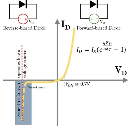

Here’s an example diode I-V curve:
From https://www.allaboutcircuits.com/technical-articles/understanding-i-v-curves-of-non-linear-devices/
The diode I-V curve has four regions, as voltage goes from negative to positive, from left to right:
  • Reverse (‘Zener’) breakdown (lots of current, continued rise with more-negative voltage)
  • Reverse bias (little or no current, just leakage)
  • Forward subthreshold (little current, rising exponentially as voltage approaches Vf)
  • Forward bias (lots of current, continued rise with more-positive voltage)
After the ‘knee’ of the threshold, about 0.7V for a silicon diode, the diode forward voltage rises with current. It behaves roughly like a low resistance.

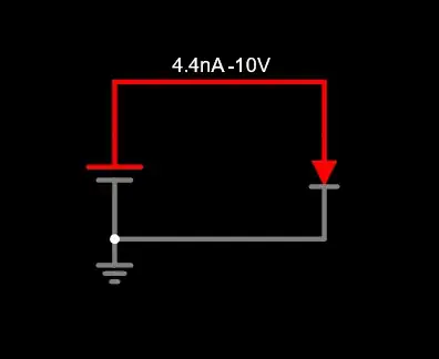

Try this out for yourself (simulate it here):
As you move the slider from left to right you can see the behavior in each state as the voltage swings from -100 to 25V.
The diode being modeled here is a 1N4148 type, a medium-current silicon switching diode. You can see that once it's in forward bias the current rises linearly with voltage. And, it Zeners out at -75V.

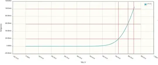

Let's select three typical points of the diode IV curve obtained by the arrangement below.
STEP 1
726.5 mV, 20 mA: Let's start with a 20 mA current value. For this purpose, we can take an empirical approach by carefully changing the voltage in the Vin parameters window until the current becomes 20 mA.

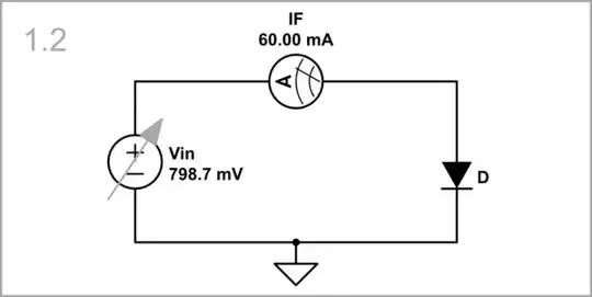

798.7 mV, 60 mA: Then we can apply the same procedure to set IF = 60 mA...
schematic
simulate this circuit

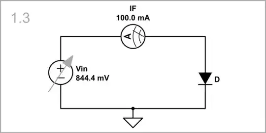

844.4 mV, 100 mA: ... and finally, to set 100 mA.
schematic

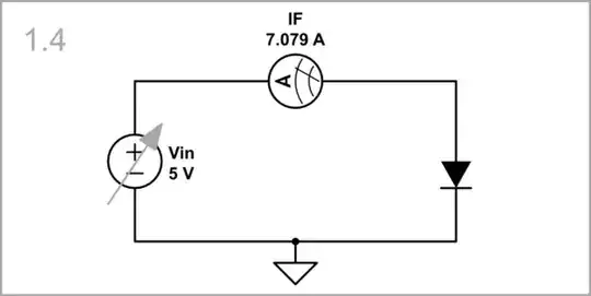

5 V, 7.079 A: Now is the time to set the abnormally high 5 V input voltage. This procedure is different from the previous ones because we directly set the voltage without caring about the current. And the result is there - abnormally high (7 A) current!
schematic
Figuratively speaking, there is a conflict like a tug of war between two constant-voltage devices - a constant voltage source and a diode, because each of them tries to set its own voltage.

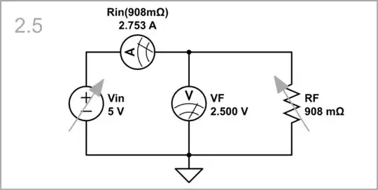

Rin = 908 mΩ inserted: To mitigate the conflict, we need to insert a small resistance in the circuit. We can get crafty and do it via the ammeter by giving it a resistance in the parameters window. But how much should this resistance be?
schematic
Let's approach it like this - to give equal chances to the source and the diode in this "fight". In other words, adjust Rin so that the voltage drop across the ammeter becomes equal to the voltage drop across the diode (half of the whole, i.e. 2.5 V).
This gives us an idea - that the diode behaves like the same 908 mΩ resistance. Then let's develop it below.

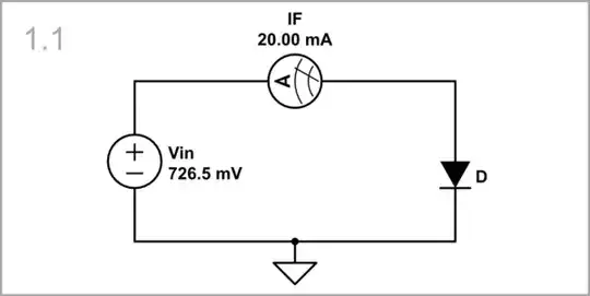

On thing that comes in my mind is that the resistance of the diode will decrease as the voltage/current increases across the diode and thus the voltage across the diode will remain a constant 0.7 across the diode...
Yes, that is a very good (my favorite) way to functionally imagine how the diode does this magic of keeping the voltage across itself constant. Now we need to repeat the three experiments above with a real diode replacing it with an equivalent variable resistor.

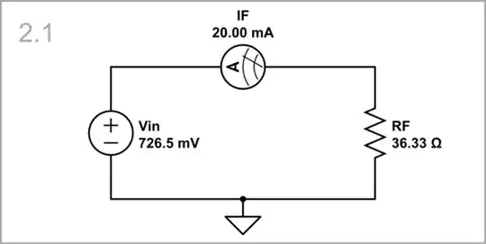

726.5 mV, 20 mA: To set 20mA current at this voltage, the diode in Schematic 1.1 behaved as a 36.33 Ω resistor; so now we replace it with such a resistor. We determine this value experimentally by adjusting the resistance so that the current is 20 mA.
schematic

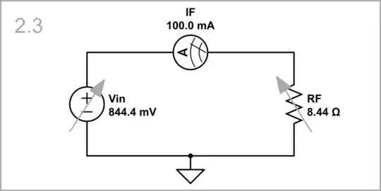

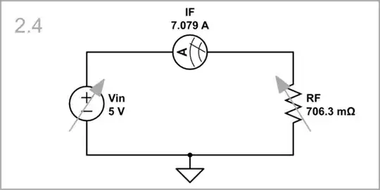

5 V, 7.079 A: When Vin increases abnormally to 5 V, the dynamic resistance becomes only 706.3 mΩ, and the current is 7.079 A!

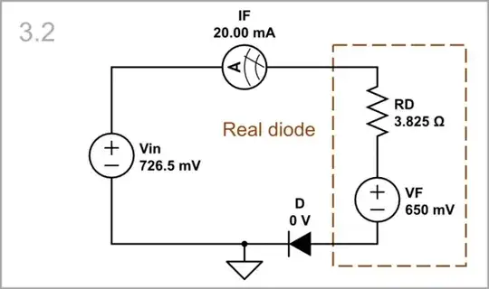

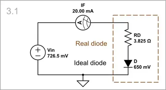

"Ideal" diode + resistor: The idea behind this simplified model is to represent the real diode as an "ideal" diode and resistor connected in series.
schematic
Accordingly, the diode IV curve is a sum of the two IV curves.
