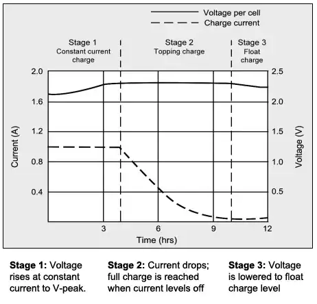

You should never, under any circumstances, provide a voltage higher than the rated peak voltage! A charging curve limits the current into the battery until the voltage rises to the peak battery voltage. Then, the voltage is limited to the peak voltage until the current drops (to 3-5% of the C rate for lead acid batteries).
Charge stages of a lead acid battery
Standard "12V" Lead-acid batteries are six cells; the peak charge voltage is between 13.8 and 14.7V (at 25C, this value is temperature dependent); however prolonged time at this voltage will cause damage. After the current reaches the cutoff point (3-5% of the C rate of the cell) the voltage should be lowered to 13.5V to 13.8V (the "float voltage").
Diagram from the excellent Battery University. Read there article on Lead Acid charging for excellent detailed information BU-403: Charging Lead Acid. Please don't attempt to build a charger or anything like it until you understand in detail the considerations and the risks; you can seriously injure yourself or others.

  • I was about to ask some questions, and your perfect edit answered all of them! So if I limit voltage to some value within [13.8v, 14.7v] and current to some value within [6A, 12A], that's essentially both of the first steps. After that, the amperage will go down 'on it's own' (the battery simply pulls less current). I should look to detect the cutoff point and subsequently lower the voltage to enter this maintenance-like float stage. Is this correct? – TrisT Dec 16 '23 at 00:45
