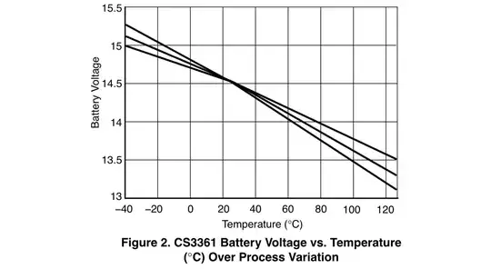

The exact charging voltage is compensated by the ambient temperature - this alternator regulating IC has a graph illustrating the Charging Voltage versus operating temperature:

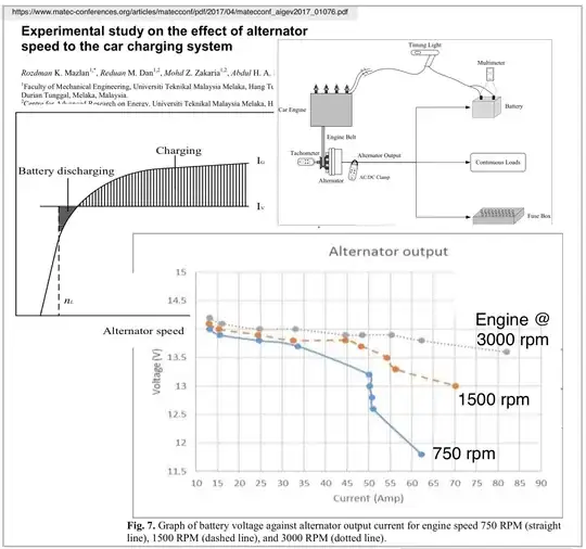

Addendum:
How a car battery is charged by an alternator-based charging system?
I found an interesting article discussing several details about the charging in more realistic situations,as variable rotation speed (RPM). Here is a collage of some figures in this article, where the colored curve graphs represent charging system response varies significantly along different engine speeds - 750 rpm, 1500 rpm and 3000 rpm.
