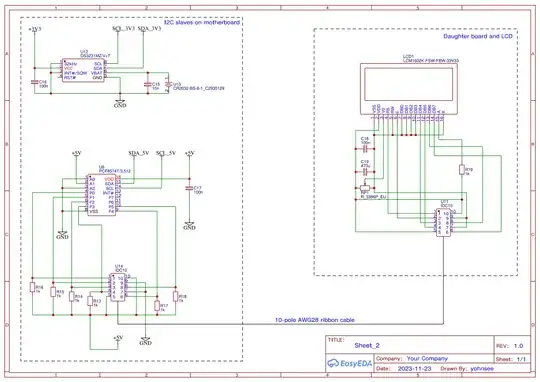

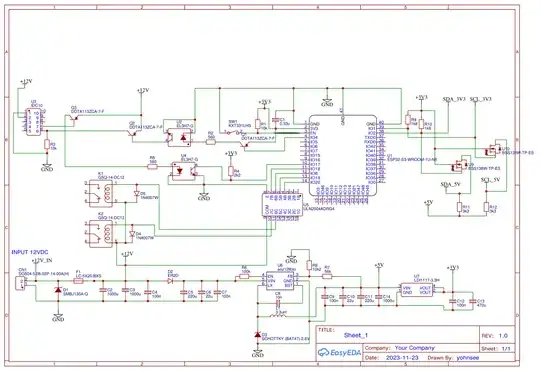

Below is a simplified schematic of my circuit, only focusing on the LCD part. Please take a look at it and tell me if you find anything obvious I could improve to have better noise immunity on the LCD line.
If possible, I want to leave the daughterboard backwards compatible and redesign/rewire it as a last resort.
schematic page 1 of 2
schematic page 2 of 2
Original PDF can be downloaded from:
https://drive.google.com/file/d/13Xz6-iv1__BDDoMWHfCxqTtLst7OPdLC/view?usp=sharing

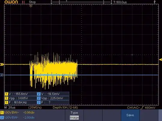

Edit: (26.11.2023) I was able to get my hands on 10x0.14mm2 shielded cable, a few ferrite beads (round a flat also) and conducted some testing. The noise source was a 12V solenoid - unknown type, around 3 Watts. The results:
  1. Without any shielding or ferrite, the oscilloscope shows the following when measuring the Vcc line of the LCD: Measurement 1

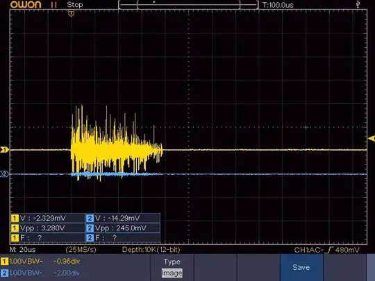

  2. Using 2 flat ferrite beads (twice as wide as my ribbon cable, so I looped my cable twice through it): Measurement 2

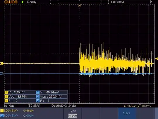

  3. Using 10x0.14mm2 round shielded cable with 2 ferrite beads, shielding tied to GND on the mainboard side: Measurement 3
I got the same results when probing the RS or EN pin. The test setup was: Voltcraft 4005 bench power supply, Owon XDS3062A oscilloscope (10x probe, AC coupling, probe attached directly on the display's pins), the solenoid was fed from the same power supply, as the mainboard. I repeated the tests by feeding the solenoid from a 12V lead-acid battery. The peak-peak voltages were about 30% lower, but still enough to confuse the display sometimes.
