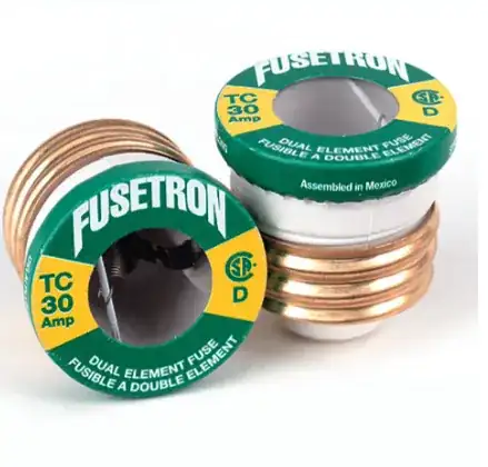

As far as fusing wall sockets, all the characteristics of the PTC resettable fuses are show-stoppers or disadvantages for that application except the resettability. For that, we have per-circuit circuit breakers in the 'fuse panel', at least in North America we do. In really old houses you can still find actual screw-in fuses like this:
